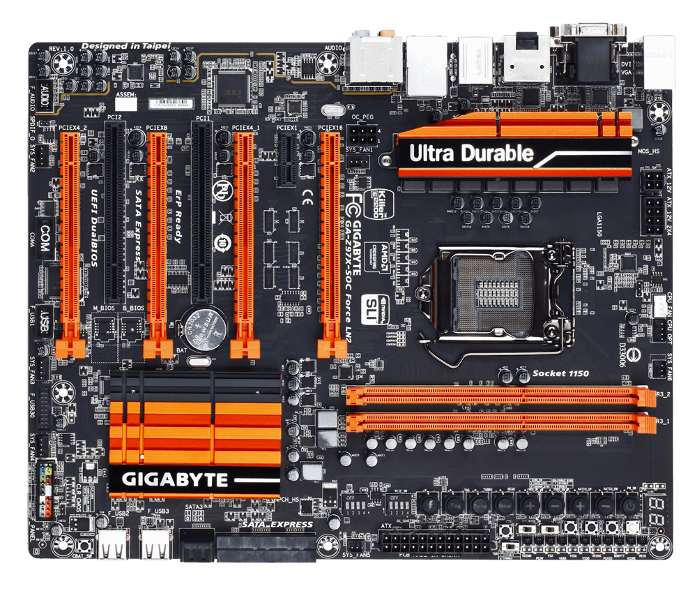

stasio Posted June 2, 2014 Author Share Posted June 2, 2014 Fiery, this board has only 2 memory slots...DDR3_1 and DDR3_2. Pic: http://www.gigabyte.com/fileupload/product/2/5086/10522_big.png Quote Link to comment Share on other sites More sharing options...
Fiery Posted June 2, 2014 Share Posted June 2, 2014 I of course understand that fact, but on your particular motherboard the SPD slots are still numbered the way AIDA64 numbers them. If you open the SMBus dump, you can see device numbers like B00-D51 and B00-D53. B00 means bus#0, so the primary SMBus. D51 and D53 means device 0x51 and 0x53 (hexadecimal values). SPD slots use the SMBus device region of 0x50 to 0x57 for a total of 8 DIMM slots supported as standard. 0x50 means DIMM1, 0x51 means DIMM2, 0x52 means DIMM3, ..., 0x57 means DIMM8. When the motherboard manufacturer incorrectly wires the SPD slot numbering, it's not the fault of AIDA64 when it displays an incorrect DIMM slot index Quote Link to comment Share on other sites More sharing options...
stasio Posted June 2, 2014 Author Share Posted June 2, 2014 Ok,I understand you. Will ask GB HQ to correct this.....(since Z87). Thanks. Quote Link to comment Share on other sites More sharing options...
Fiery Posted June 2, 2014 Share Posted June 2, 2014 I'm not sure if they can fix that. I suspect the issue comes from the motherboard PCB wiring... Plus, it doesn't bring any actual problem to either the operating system or to the user Quote Link to comment Share on other sites More sharing options...
stasio Posted June 2, 2014 Author Share Posted June 2, 2014 Yea,I know this. Since Z87, they rotate (180 degree) complete memory slots,but they use old PCB wiring..as you said. The DIMMs on LGA1150 are rotated 180 degrees when compared to LGA1155, this reduces on die latency of the IMC. I'll see what I can do. Thanks again. Quote Link to comment Share on other sites More sharing options...
