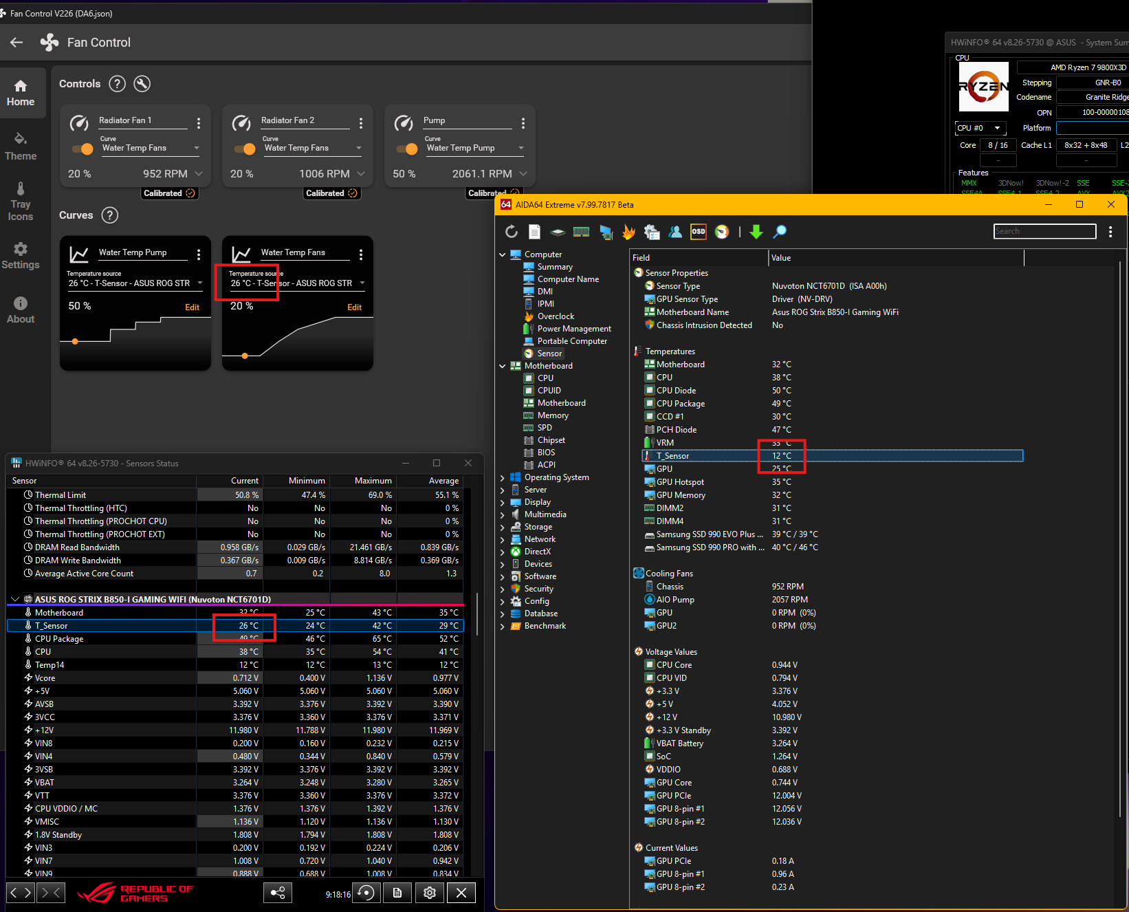

  1. Issue is fixed! Thank you! And apologies, I should've used the search function before making a post. Thanks again!
  2. Here's the new ISA sensor dump. T_Sensor reading from HWinfo64 was 26C. Thanks! isasensordump.txt
  3. Hi Fiery, have the same motherboard but with a 9800x3d. The latest beta is still showing the wrong temp for me - 12C. FanControl and HWinfo64 are reporting the BIOS temp. Attached an ISA sensor dump to maybe help troubleshoot. Thank you! isasensordump.txt
  4. Using the AIDA64 Extreme Beta 7.99.7817, the t_sensor reading seems to be stuck at 12 C. HWinfo64 and FanControl are both reading the correct temperature. Motherboard is an Asus B850i with latest BIOS. Temperature sensor is an EK fitting. I tried to use stable version that came with the motherboard, but there were a lot of sensors that didn't appear, including t_sensor. Hopefully this will be an easy fix.
