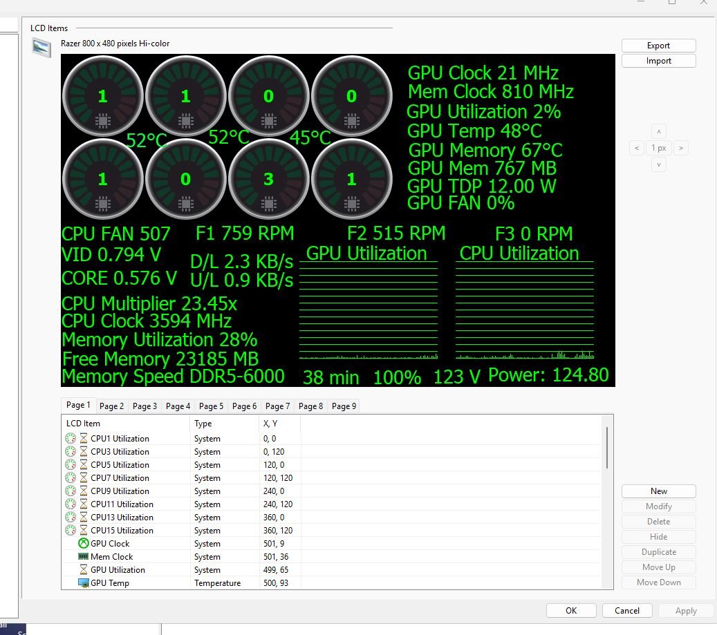

Downloading and installing the new 64bit 8.0 release does not uninstall or migrate the old 32 bit version. It does not import the LCD panel info, or the licence key and leaves the whole directory intact in program files (x86). What files do i need to move to get my LCD back, and the license key? Temporarily, I copied the entire old folder to the new directory, and ran an update but thats messy and leaves a lot of old unneeded files in the directory

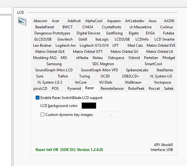

looks like the newest version of AIDA64 has reverted to the SDK2 drivers for the LCD. I haven't updated in a while, so i don't know how long its been like that. i downloaded 7.99.7809 beta from june and overwrote the current install and its back to working.
as a side note, its way more stable with the USB drivers. The old razer driver used to crash aida64 fairly often. I haven't had a single aida app crash since using the new usb drivers.
Works great. Better than you thought actually. Couple things 1. only needed to change the driver. nothing else. 2. Moving a copy of the libusb dll wasn't necessary. Although maybe that's because i havent deleted the driver install directory. Ill keep an eye on that. 3. Synapse software is still fully functional. Lighting changes can be done at any time without changing the driver back. 4. Touchscreen mouse of the switchblade screen still fully functional. 5. Driver and lighting survives reboot. Effectively no change to any functions from before. Actually better: now accidentally hitting one of those dynamic keys doesn't make my LCD layout disappear and have to spend 10 minutes to figure out how to get it back.
I only use a single page for the layout and have never used those buttons and the worthless apps they open. if i have to lose access to the touchpad functionality i suppose i can live with that although like i mentioned, its a separate driver and i'm pretty sure it still works without the framework. the lighting profile i believe is stored on the keyboard hardware (it survives reboot and is active during post/bios) so theoretically i could fire up the framework when i need to change it, then disable it after to allow aida to run the layout if it interferes.
yes, the old ass DetahStalker Ultimate..ive rebuilt it twice from ebay purchases... i just cant bear to get rid of it, i love the switchblade with aida on it.... i dont use any of the other features of the framework other than changing the lighting periodically, and occasionally the touchscreen mouse when my main mouse goes wacky (which i believe is a standalone driver anyway by synaptics) Ive done a search of my machine, and there appears to be only one copy of the .dll, so i doubt there is a 64bit version. I actually did try to put a copy in the aid64 program directory when i was troubleshooting but it didnt work. Razer may have one they never released.
RazerSwitchblade LCD stopped working. If i cycle the LCD option, it says it cant find RzSwitchladeSDK2.dll The SDK appears installed in the proper Razer directory, and the DLL is present. EDIT: I rolled back to the stable release, and it works again. Appears to be an issue with the newest beta.
