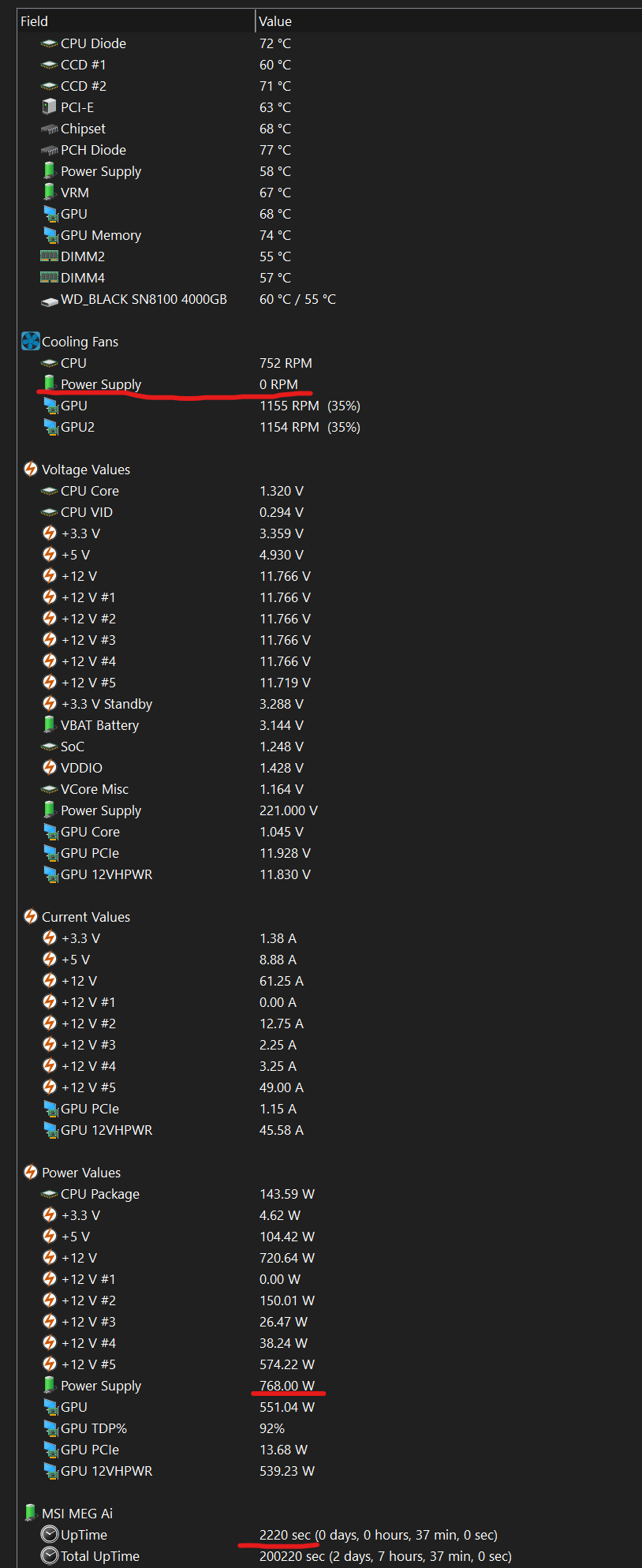

  3. Hi @Fiery I noticed in the version 6.88.6403 that this PSU FAN is reported at 8 RPM when it is stopped - instead of 0.
  4. Thank you, it's way better now! 1/ I confirm that the Fan speed on MSI PSU is reported correctly now. 2/ Also the PSU metrics are working now after the sleep mode. 3/ On Win11 + Ryzen 7950x the CPU utilization by core works well only if the option "Windows 11 CPU utilization measurement workaround" is DISABLED.

  7. Thank you, the latest beta detects the power supply The fan speed doesn't report the right RPM. It sits at 2048 when the fan is in reality at 0. The wattage and temperature is reported properly.
