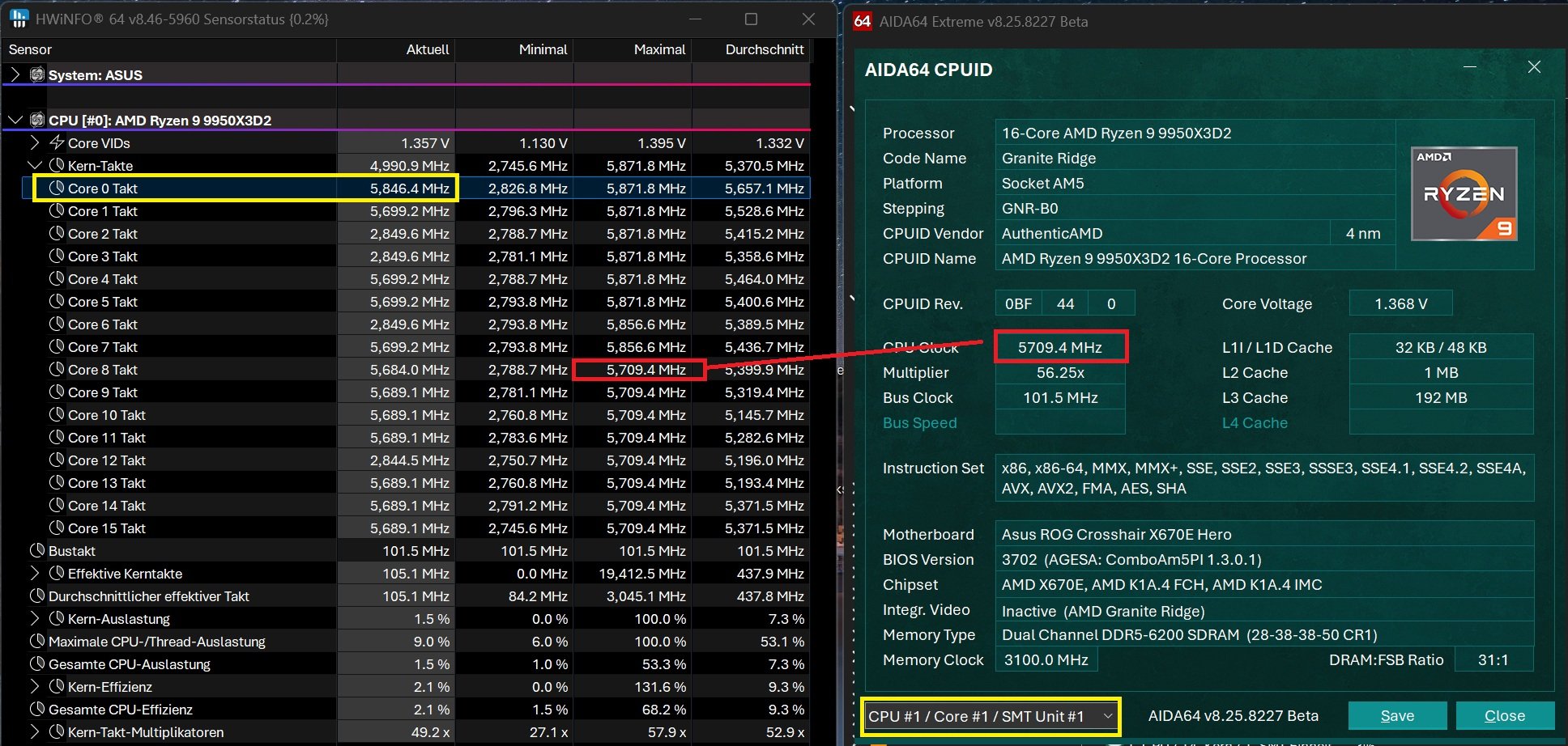

  5. Hello I Found a bug from the 9950X3D2 CCD0 Clock Speed AIDA64 reads allways the Clock Speed from CCD1 and not CCD0 when i start a Game or Programm it only works in the Idle I Made a Screenshot when i run a Game and i use the lastest Beta Version 8227
