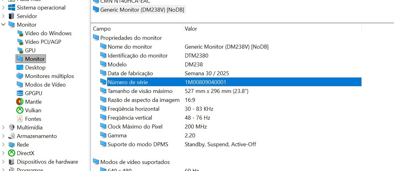

Leonardo Santana Posted May 24, 2024 Posted May 24, 2024 I need to ensure that the monitor manufacturer is displayed in the report. Currently it only identifies as "Generic monitor" + model. Is there any relationship with ID Monitor. Version: AIDA64 v6.92.6600/br Portuguese - Brazil [ Generic Monitor (DM238) [NoDB] ] Propriedades do monitor: Nome do monitor Generic Monitor (DM238) [NoDB] Identificação do monitor DTN2380 Modelo DM238 Data de fabricação Semana 21 / 2024 Número de série 1M44587010001 Tamanho de visão máximo 527 mm x 296 mm (23.8") Razão de aspecto da imagem 16:9 Freqüência horizontal 30 - 83 KHz Freqüência vertical 48 - 75 Hz Clock Máximo do Pixel 250 MHz Gamma 2.20 Suporte do modo DPMS Active-Off Quote
Fiery Posted May 24, 2024 Posted May 24, 2024 16 minutes ago, Leonardo Santana said: I need to ensure that the monitor manufacturer is displayed in the report. Currently it only identifies as "Generic monitor" + model. Is there any relationship with ID Monitor. Version: AIDA64 v6.92.6600/br Portuguese - Brazil [ Generic Monitor (DM238) [NoDB] ] Propriedades do monitor: Nome do monitor Generic Monitor (DM238) [NoDB] Identificação do monitor DTN2380 Modelo DM238 Data de fabricação Semana 21 / 2024 Número de série 1M44587010001 Tamanho de visão máximo 527 mm x 296 mm (23.8") Razão de aspecto da imagem 16:9 Freqüência horizontal 30 - 83 KHz Freqüência vertical 48 - 75 Hz Clock Máximo do Pixel 250 MHz Gamma 2.20 Suporte do modo DPMS Active-Off We'll add your monitor to the hardware database of AIDA64 in the next update due next week. Quote
Solution Leonardo Santana Posted May 24, 2024 Author Solution Posted May 24, 2024 is a new monitor manufacturer in Brazil. Daten Quote
Leonardo Santana Posted September 11, 2025 Author Posted September 11, 2025 Based on the UEFI PNP ID registry, the manufacturer Daten changed its ID to DTM last year, as per the AIDA report. I need the new ID to be linked to "Daten." PNP ID Registry | Unified Extensible Firmware Interface Forum [ Generic Monitor (DM238V) [NoDB] ] Propriedades do monitor: Nome do monitor Generic Monitor (DM238V) [NoDB] Identificação do monitor DTM2380 Modelo DM238 Data de fabricação Semana 30 / 2025 Número de série 1M00809040001 Tamanho de visão máximo 527 mm x 296 mm (23.8") Razão de aspecto da imagem 16:9 Freqüência horizontal 30 - 83 KHz Freqüência vertical 48 - 76 Hz Clock Máximo do Pixel 200 MHz Gamma 2.20 Suporte do modo DPMS Standby, Suspend, Active-Off Quote
Fiery Posted September 13, 2025 Posted September 13, 2025 On 9/11/2025 at 8:20 PM, Leonardo Santana said: Based on the UEFI PNP ID registry, the manufacturer Daten changed its ID to DTM last year, as per the AIDA report. I need the new ID to be linked to "Daten." PNP ID Registry | Unified Extensible Firmware Interface Forum [ Generic Monitor (DM238V) [NoDB] ] Propriedades do monitor: Nome do monitor Generic Monitor (DM238V) [NoDB] Identificação do monitor DTM2380 Modelo DM238 Data de fabricação Semana 30 / 2025 Número de série 1M00809040001 Tamanho de visão máximo 527 mm x 296 mm (23.8") Razão de aspecto da imagem 16:9 Freqüência horizontal 30 - 83 KHz Freqüência vertical 48 - 76 Hz Clock Máximo do Pixel 200 MHz Gamma 2.20 Suporte do modo DPMS Standby, Suspend, Active-Off Thank you, we will add that monitor to the next AIDA64 update. Quote

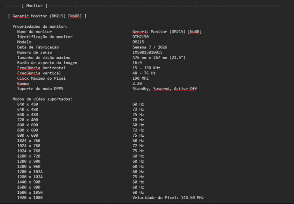

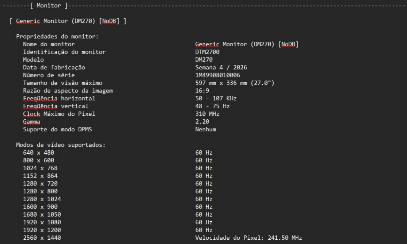

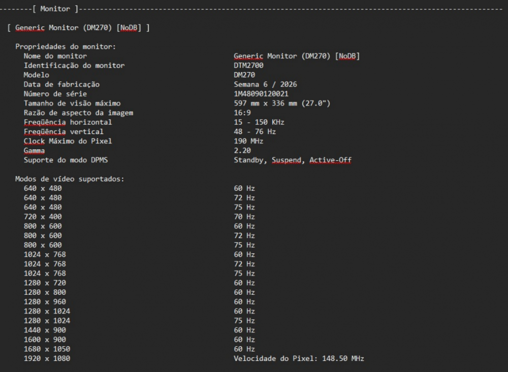

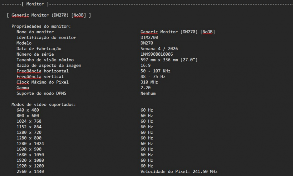

Leonardo Santana Posted February 12 Author Posted February 12 Hello AIDA Team, We have 2 more monitor models from the manufacturer Daten. [ Generic Monitor (DM270) [NoDB] ] Propriedades do monitor: Nome do monitor Generic Monitor (DM270) [NoDB] Identificação do monitor DTM2700 Modelo DM270 [ Generic Monitor (DM215) [NoDB] ] Propriedades do monitor: Nome do monitor Generic Monitor (DM215) [NoDB] Identificação do monitor DTM2150 Modelo DM215 Quote
Fiery Posted February 12 Posted February 12 12 hours ago, Leonardo Santana said: Hello AIDA Team, We have 2 more monitor models from the manufacturer Daten. [ Generic Monitor (DM270) [NoDB] ] Propriedades do monitor: Nome do monitor Generic Monitor (DM270) [NoDB] Identificação do monitor DTM2700 Modelo DM270 [ Generic Monitor (DM215) [NoDB] ] Propriedades do monitor: Nome do monitor Generic Monitor (DM215) [NoDB] Identificação do monitor DTM2150 Modelo DM215 Thank you! If you could kindly also include the timing parameters and native resolution of those displays, we could add them with more details. Quote
Douglas C Souza Posted February 13 Posted February 13 22 hours ago, Fiery said: Obrigado! Se você pudesse incluir também os parâmetros de temporização e a resolução nativa desses monitores, poderíamos adicioná-los com mais detalhes. Quote

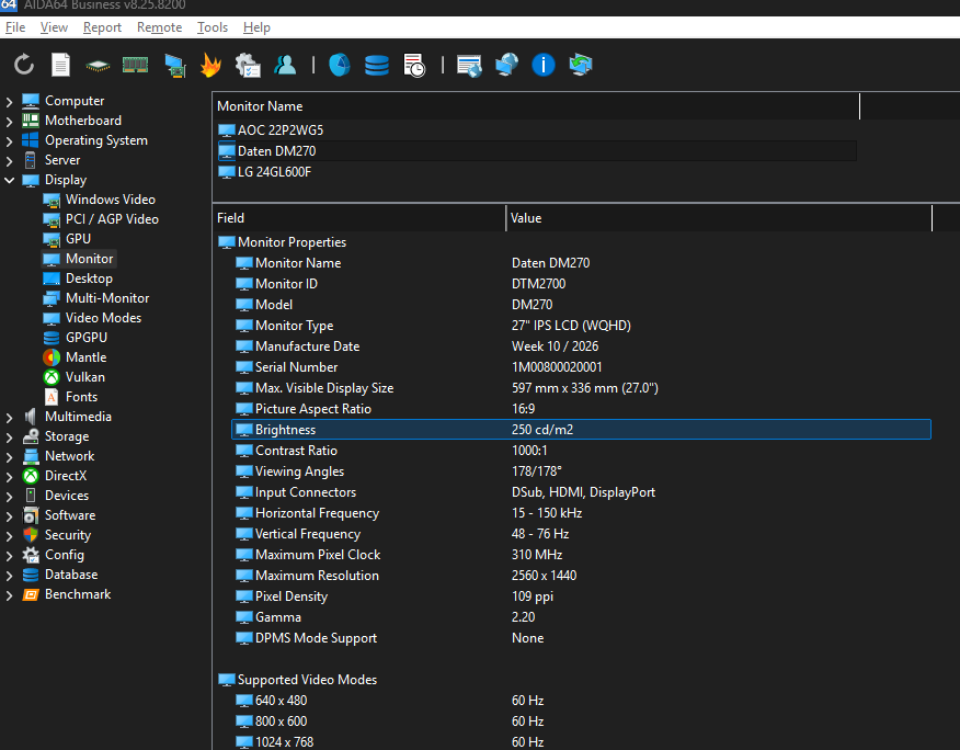

Fiery Posted February 26 Posted February 26 On 2/18/2026 at 2:43 PM, Leonardo Santana said: @Fiery When will the update be available? It's been rolled out 2 days ago as AIDA64 v8.25: Quote
Leonardo Santana Posted March 6 Author Posted March 6 Hi @Fiery For Daten monitors, this input connector information may vary. The model alternates between DbSub, HDMI, and DP inputs. Some variations may only come with DbSub and HDMI or HDMI and DP. To avoid discrepancies, it would be advisable to remove this input connector information for Daten models. ReportMOnitor.htm Quote
Fiery Posted March 10 Posted March 10 On 3/6/2026 at 3:20 PM, Leonardo Santana said: Hi @Fiery For Daten monitors, this input connector information may vary. The model alternates between DbSub, HDMI, and DP inputs. Some variations may only come with DbSub and HDMI or HDMI and DP. To avoid discrepancies, it would be advisable to remove this input connector information for Daten models. Thank you, we've removed that information from our monitor database Quote
Leonardo Santana Posted 4 hours ago Author Posted 4 hours ago Hi @Fiery Specifically for Daten DM270 monitor models. The brightness should be set to 300 cd/m2. Quote
