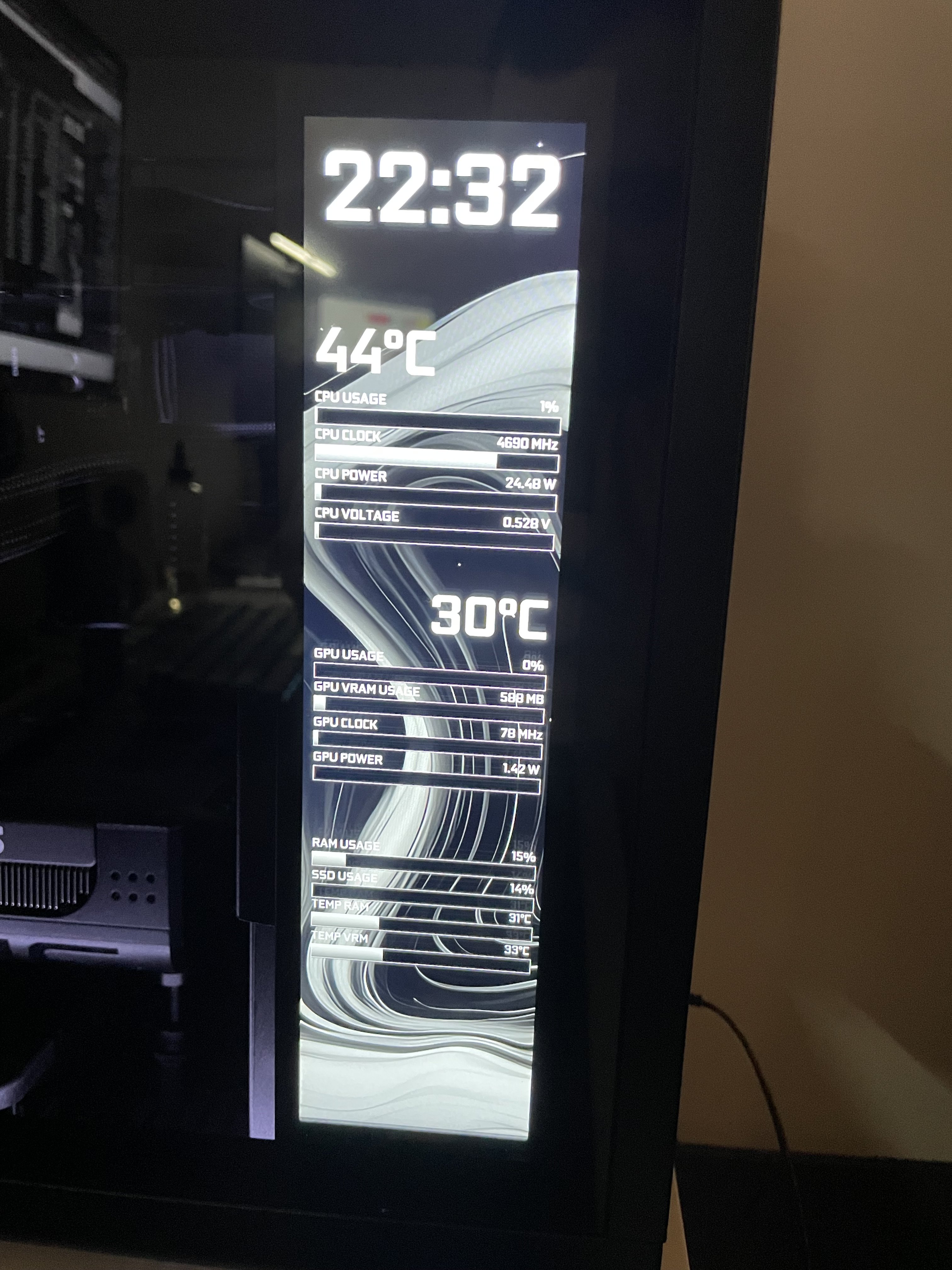

balaM Posted May 19 Posted May 19 16 minutes ago, Fiery said: @psg237 @balaM @DavidA @Tamerz @johnskiller @Zaeedi @Amex72 @DracoCW @MaxOut @sancho76 We've been able to implement full support for Turing (Turzx) 8.8-inch v1.1 LCD screens. Please check it out and let us know how it works. https://www.aida64.com/downloads/latesta64xebeta Please note that due to firmware limitations (of the 8.8-inch v1.1 screen), complex LCD layouts may be forced to be sliced up to multiple parts before submitting the image via the USB connection. It yields to a certain flashing effect that we sadly cannot avoid. You can mitigate the issue by using a lower LCD update frequency like 2 or 3 seconds. Hello, thx for the update. big progress !! i still have a issue, i attach a video so u can see. like the background turzx screen flashing IMG_0097.MOV Quote
balaM Posted May 19 Posted May 19 14 minutes ago, balaM said: Hello, thx for the update. big progress !! i still have a issue, i attach a video so u can see. like the background turzx screen flashing IMG_0097.MOV My bad i just notice that u explain this flashing effect. That really sad even if i increase LCD update frequency it look weird to me Quote
Fiery Posted May 19 Author Posted May 19 59 minutes ago, balaM said: My bad i just notice that u explain this flashing effect. That really sad even if i increase LCD update frequency it look weird to me You can get around it only by lowering the rendered image size. For example, by using a simpler background image (or no background image at all). Quote
balaM Posted May 19 Posted May 19 15 minutes ago, Fiery said: You can get around it only by lowering the rendered image size. For example, by using a simpler background image (or no background image at all). wow ok, it work without background image !!!! i'll try to lower the rendered image size. but right now work perfectly !!! Quote
balaM Posted May 19 Posted May 19 I dont know HOW but i managed to make it work with full image size, it all depend how many "items" u put on the screen and how far to the bottom (i mean it have to reach a certain point to the bottom to work). Quote
balaM Posted May 19 Posted May 19 11 minutes ago, balaM said: I dont know HOW but i managed to make it work with full image size, it all depend how many "items" u put on the screen and how far to the bottom (i mean it have to reach a certain point to the bottom to work). only issue i notice from now is i cant control the brightness of the screen. Quote
Fiery Posted May 20 Author Posted May 20 9 hours ago, balaM said: I dont know HOW but i managed to make it work with full image size, it all depend how many "items" u put on the screen and how far to the bottom (i mean it have to reach a certain point to the bottom to work). It all depends on the final size of the rendered PNG image that is to be submitted to the device. If the PNG is no more than 512KB in size, it can be displayed using a single USB command, and then no flickering will be experienced. If however the PNG is larger than 512KB, it has to be sliced up and then you have to live with the flickering issue I assume the manufacturer of the 8.8-inch v1.1 Turing screen will fix or mitigate this issue in an upcoming firmware, but I'm not sure if it will be possible to update the firmware at home. So you may need to buy a new screen to get the fix Quote
Fiery Posted May 20 Author Posted May 20 9 hours ago, balaM said: only issue i notice from now is i cant control the brightness of the screen. We're working on it Quote
Fiery Posted May 20 Author Posted May 20 17 hours ago, balaM said: wow ok, it work without background image !!!! i'll try to lower the rendered image size. but right now work perfectly !!! We'll increase the limitation on PNG file size from 512KB to 1MB in the next beta update. This will enable you to design more complex layouts without the flickering effect. However, anything beyond 1MB is not safe, since it locks the firmware of the device up 1 Quote

Fiery Posted May 25 Author Posted May 25 On 5/19/2025 at 10:46 PM, balaM said: only issue i notice from now is i cant control the brightness of the screen. It's been implemented in the latest AIDA64 beta update available at: https://www.aida64.com/downloads/latesta64xebeta We've also increased the maximum image size that can be transferred without slicing it up to multiple pieces. That will allow you to build more complex layouts without having to live with the flickering artifact. 1 Quote
