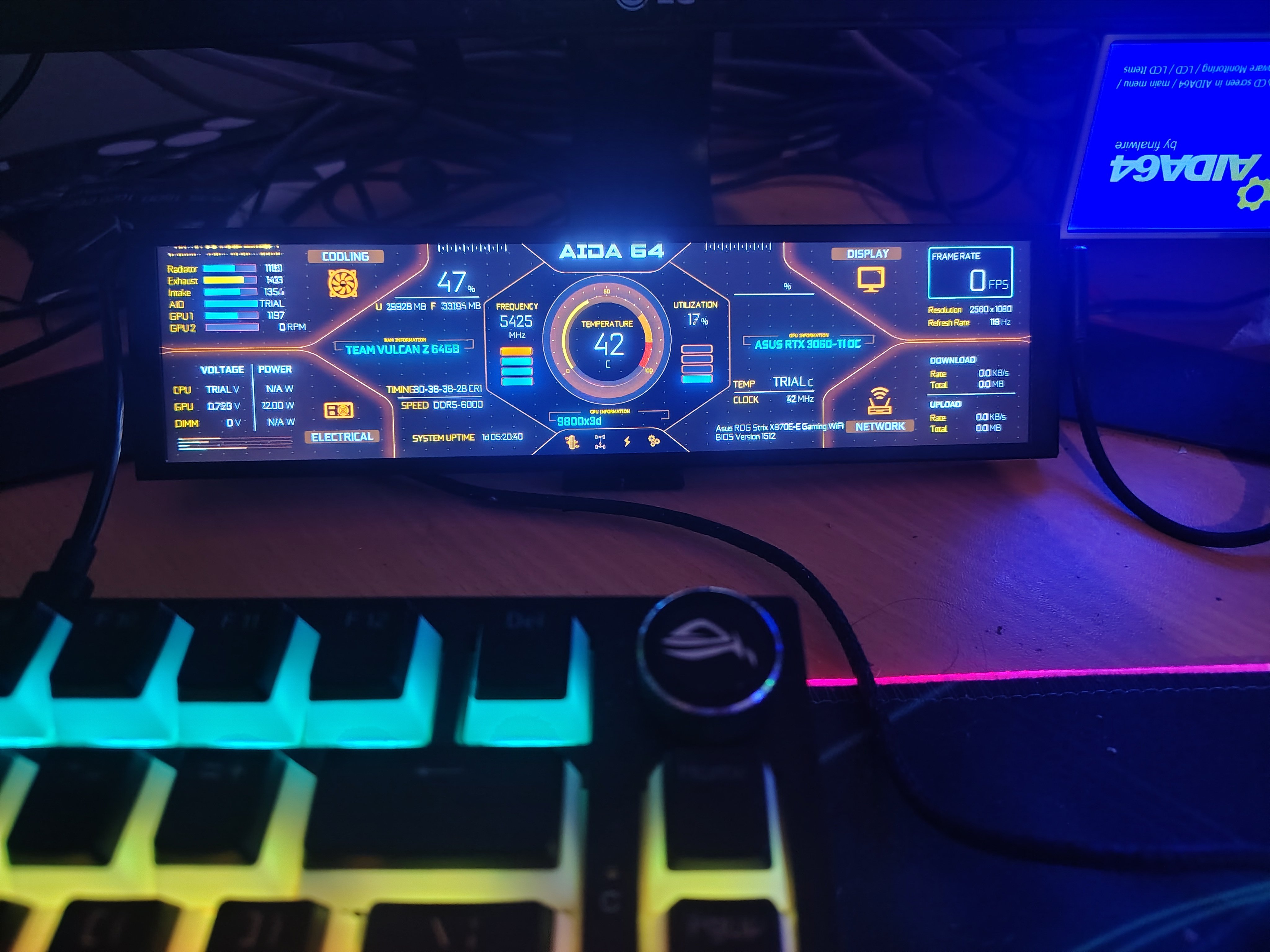

grAvox Posted August 13 Posted August 13 Up and running like a champ. did have a little issue where it disconnected for no real reason but started it up again and its running perfect. i dont know if you could implement an option to rotate individual turing displays independently of each other? would be a great feature as all my screens are round different ways lol. Thanks again your the man @Fiery, will get the dump of the 8 inch tomorrow. Quote

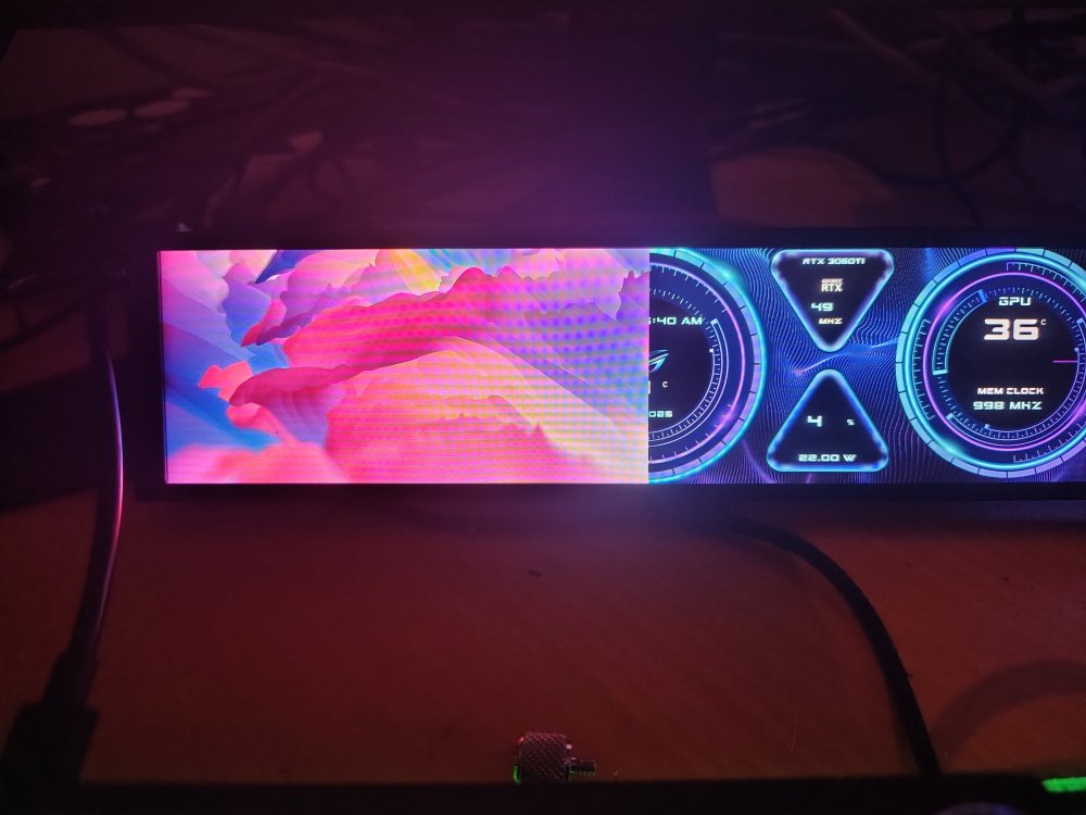

grAvox Posted August 13 Posted August 13 @Fiery noticed one little issue with some panel files. half the screen starts flashing the last image that was on it before loading into aida. doesn't happen with all just some. not sure if there is an issue with my particular screen or is it a limitation like i was reading earlier on in this thread? Photo: Quote
Fiery Posted August 13 Author Posted August 13 11 minutes ago, grAvox said: @Fiery noticed one little issue with some panel files. half the screen starts flashing the last image that was on it before loading into aida. doesn't happen with all just some. not sure if there is an issue with my particular screen or is it a limitation like i was reading earlier on in this thread? Photo: The firmware of the latest Turing screens is quite peculiar when it comes to how they update frames. Once the size of the image toe be sent to the display becomes too large, AIDA64 has to cut it in half to make sure the firmware can "digest" the data. So as your layout becomes more complex, the rendered image may cross over the threshold and would mean that it sadly has to be sliced up to make it work with the firmware. Quote
grAvox Posted August 13 Posted August 13 Ahh i see, is that something that could be remedied later on down the track? the files that it happens with do have a very complex image too them so now i understand. hopefully it can all be sorted later on down the track. Thanks again! Quote
Fiery Posted August 13 Author Posted August 13 6 minutes ago, grAvox said: Ahh i see, is that something that could be remedied later on down the track? the files that it happens with do have a very complex image too them so now i understand. hopefully it can all be sorted later on down the track. Thanks again! It can only be remedied in case Turing provides a firmware update for their screens that would fix this issue. But I don't think the firmware can be updated on Turing screens at all 1 Quote

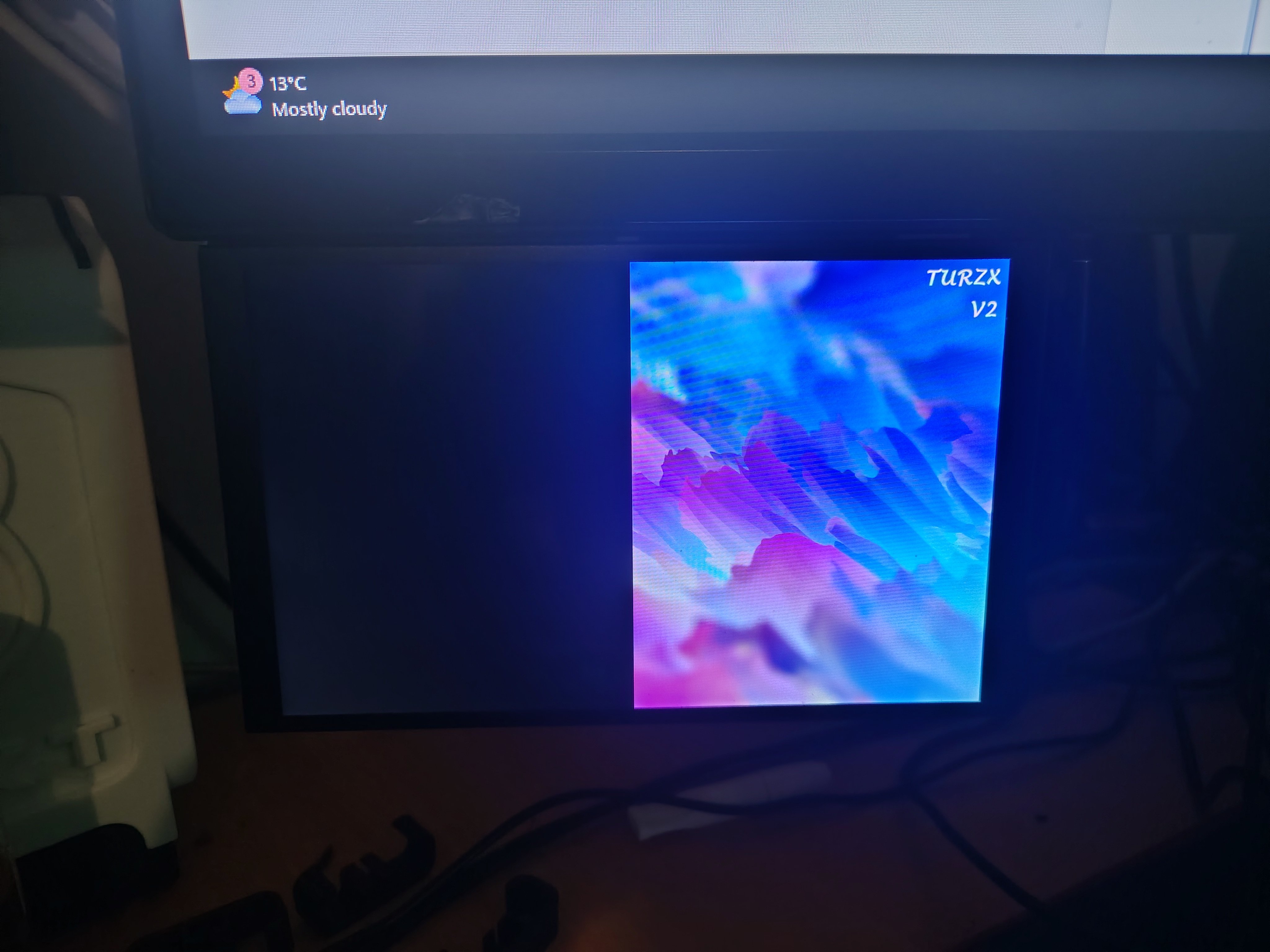

grAvox Posted August 23 Posted August 23 @Fiery It doesn't seem to work on my end properly, i did get it to display one line of text over the half filled screen from a full sensor panel but that was it and it only shows half the screen. Cant seem to move past here tried different cables usb ports ect but no luck. Has it been tested by anyone else yet?? im not sure if im an isolated case or its just not working as it should as of yet. will wait to hear your input thanks again! Quote
Fiery Posted August 25 Author Posted August 25 On 8/23/2025 at 10:40 PM, grAvox said: @Fiery It doesn't seem to work on my end properly, i did get it to display one line of text over the half filled screen from a full sensor panel but that was it and it only shows half the screen. Cant seem to move past here tried different cables usb ports ect but no luck. Has it been tested by anyone else yet?? im not sure if im an isolated case or its just not working as it should as of yet. will wait to hear your input thanks again! Thank you for your feedback! There's a chance the protocol has changed since the v1.1 version of the 8.8-inch screen We will need to acquire a 8-inch screen to study its behavior. Where did you purchase your 8-inch screen from? Quote

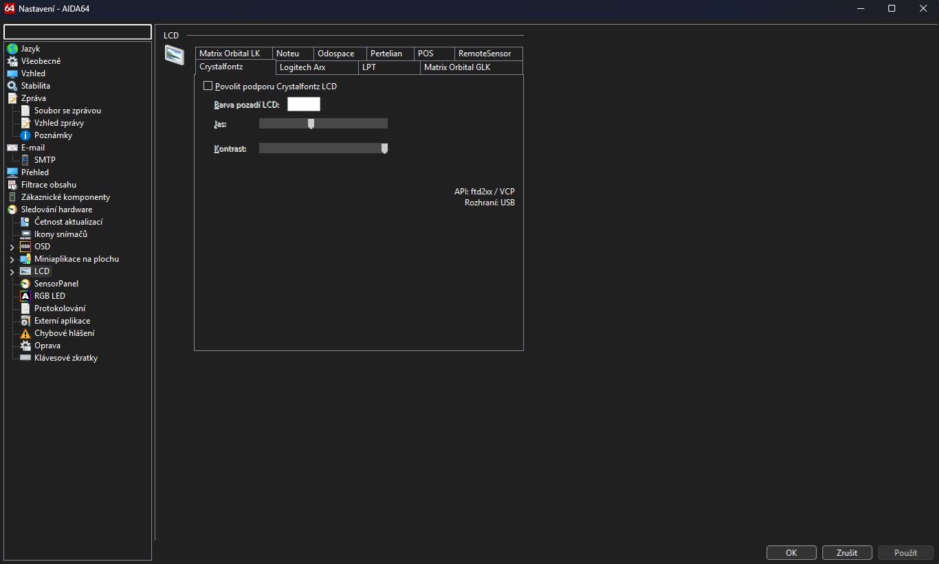

Majk450 Posted August 25 Posted August 25 On 8/23/2025 at 5:33 PM, Fiery said: @grAvox Thank you! We've implemented support for the new 8-inch Turing screen in the latest AIDA64 beta update: https://www.aida64.com/downloads/latesta64xebeta I don't see other LCD. Is it somewhere in the settings how to enable other manufacturers? Quote
Fiery Posted August 25 Author Posted August 25 Just now, Majk450 said: I don't see other LCD. Is it somewhere in the settings how to enable other manufacturers? We've changed the layout of that page to only show connected and recognized LCD devices. If you wanna have it show every device, right-click on the header of the page (e.g. on Cyrstalfontz) --> Show All. Quote
Majk450 Posted August 25 Posted August 25 9 minutes ago, Fiery said: We've changed the layout of that page to only show connected and recognized LCD devices. If you wanna have it show every device, right-click on the header of the page (e.g. on Cyrstalfontz) --> Show All. Thank you, I see now, however it is still the same on the 8" turing version - USB device not found. Quote
Fiery Posted August 25 Author Posted August 25 58 minutes ago, Majk450 said: Thank you, I see now, however it is still the same on the 8" turing version - USB device not found. Are you using the latest AIDA64 beta build of 7852? https://www.aida64.com/downloads/latesta64xebeta Quote
