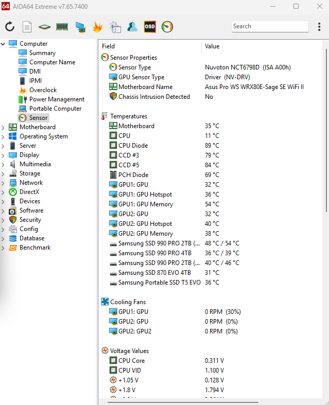

As above. But the curves of the BIOS are seeing through this and all fans are now at max speed. How can I fix this?

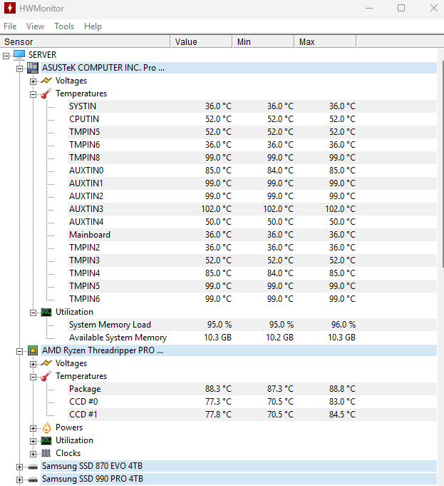

P.S. There is no "11°C" temp in HWMonitor (second pic).

In AIDA64 please press Ctrl+D --> Sensor Debug --> ISA Sensor Dump. Copy-paste the full results into this topic, or attach the results as a TXT file to your post.
Thanks,
Fiery

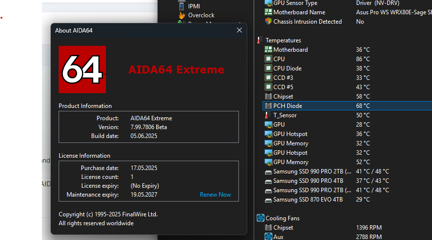

Thank you!  Please upgrade to the latest beta version of AIDA64 Extreme available at:
Posted
Thank you Fiery! I attach a pic of the situation after the update.
Now, the CPU temp is at 86°C when idle and it needs 100% load for a whole minute to get to 87°C. Via IPMI, I get 36°C when idle. Also, now I can read the T_Sensor measuring the loop temp just before entering the hot section, which is great. But I get 50°C in AIDA64 and 28°C in the IPMI.
I also attach a new isa dump.
isasensordump_2.txt
Posted
Thank you!  Can you please create 2 different ISA Sensor Dumps, one at idle, the other one at load, and also check both the CPU temperature and TSensor temperature reading in IPMI and send those to me as well?
Problem is, there're a bunch of thermal readings for your motherboard and it's quite difficult to figure out which is which :(  Here's the list:
     10    11    12    13    15    16    1B    20    52    57    65    71    73    75    7C
T:   36    36    86   102   104    50    86    36     0     0   255    11    11    36   255
Obviously stuff like zero, 11, 102, 104 and 255 Celsius are bogus readings, but the rest could well be the CPU temperature.

Thank you!  Funnily enough, none of the thermal readings correspond to the CPU temperature :) So we will simply remove it.  You can focus on the CPU Diode temperature reading that is directly read from the CPU itself.
