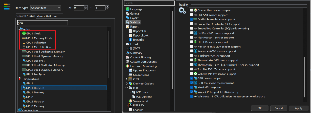

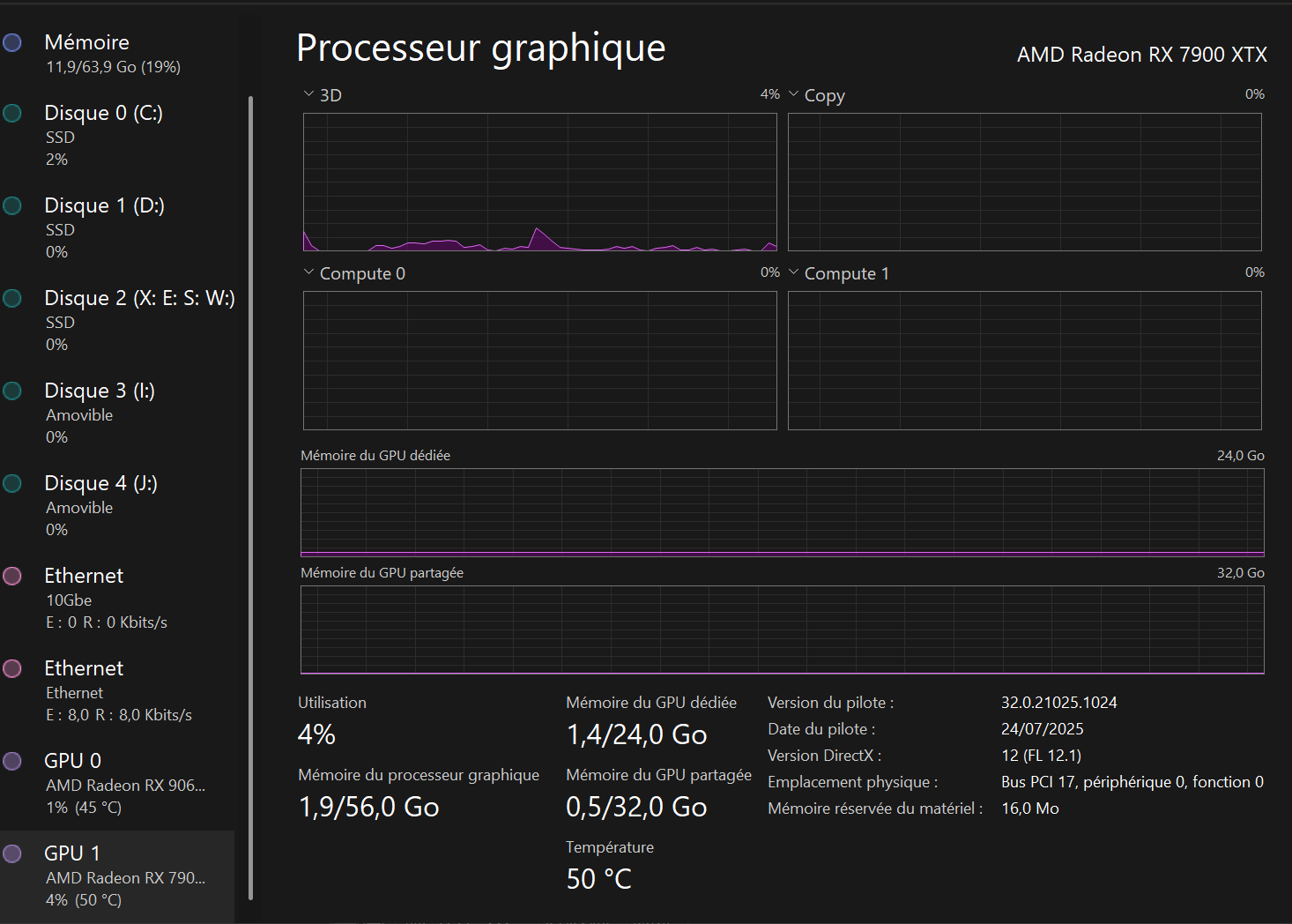

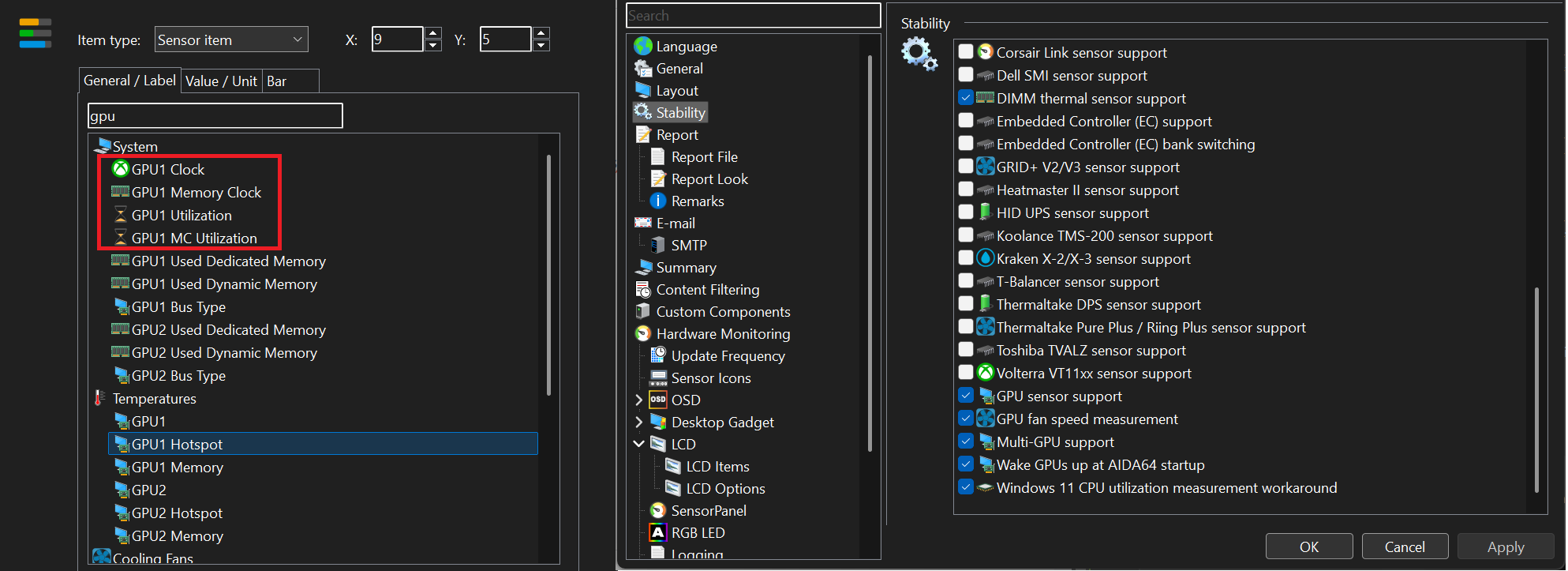

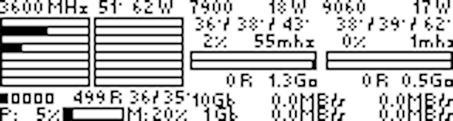

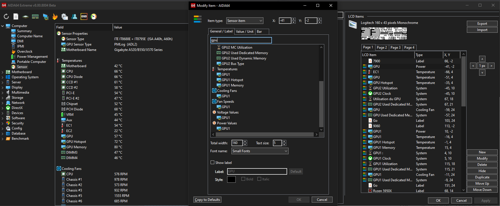

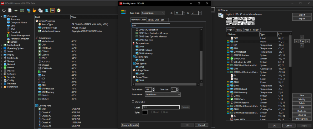

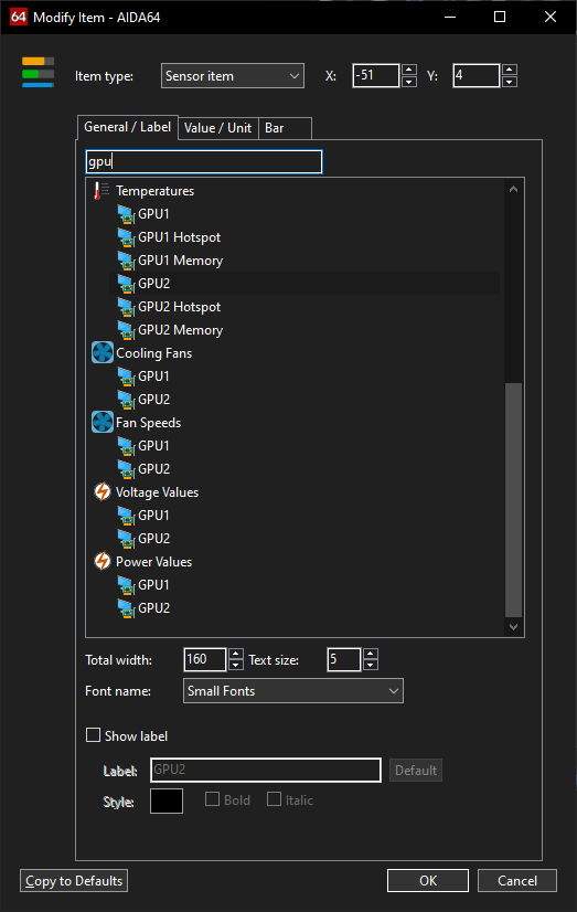

EvWvE Posted Sunday at 12:00 PM Posted Sunday at 12:00 PM Hello, I'm using Aida64 with old G15 display to monitor my hardware, but I adding a second Gpu to my Rig , and some sensors is missing. 2 Gpu are active in same time (multi monitors connected to each GPU) - Multi gpu support enabled - Wake up Gpu : enable - ULPS disable in Registry. (or enable change nothing) Gpu1 clock / utilization / Memory clock Are present, but No sensors available for GPU2 Utilization / clock GPU-Z and Windows Taskmgr can have this information, but can't use it for my G15 display I try to reset Aida64 (deleting Aida64.ini) Using last beta (7.99.7852beta) Fresh Windows 11 install Using last AMD drivers available (28.8.1) I don't kown if this is a bug, or Aida64 limitation ? or something other ? Thanks Quote

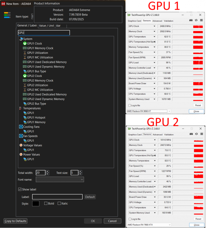

EvWvE Posted Sunday at 02:32 PM Author Posted Sunday at 02:32 PM ATI GPU Registers atigpureg.txt Quote

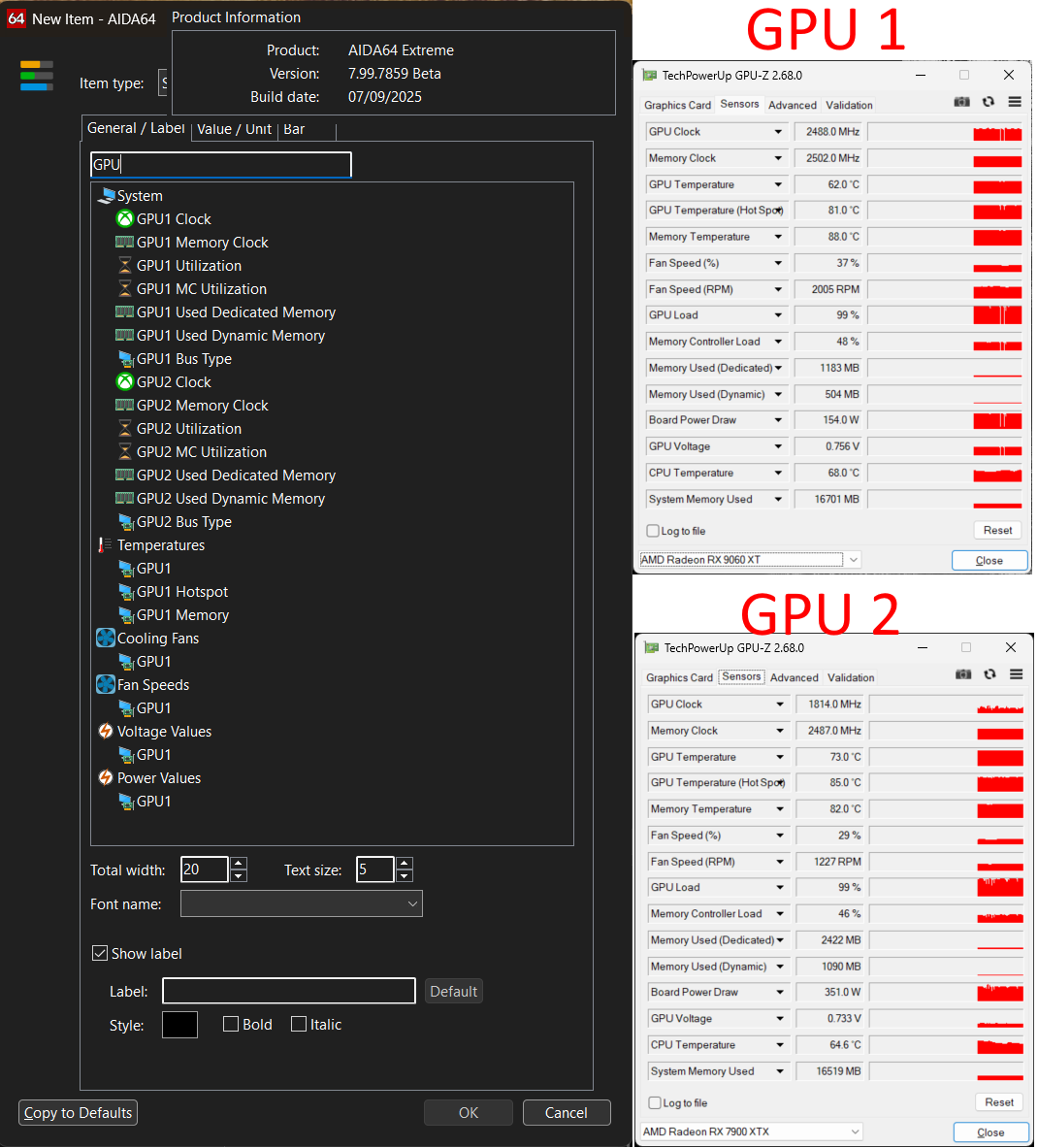

EvWvE Posted 17 hours ago Author Posted 17 hours ago I don't know if it can be usefull informations: Aida detect only the card in the first slot, 1st slot used by Windows to boot. In my case, after machine boot I can close AIDA64, desactivate my 9060Xt with windows peripherals manager to keep only the 7900xtx active, and relaunch AIDA64, Result is worse, no more Clock or Gpu utilization available. My bios is configured to use "PCIE-2 Initial Display" (even with that windows boot using GFX in First PCIE) Quote
