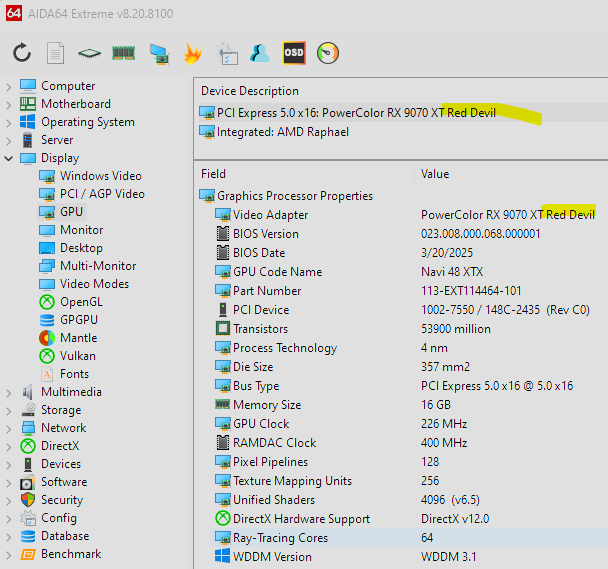

Peregrine Posted December 28, 2025 Posted December 28, 2025 I have a PowerColor RX 9070 XT HellHound. But in AIDA64 v.8.20.8100 it's being misreported as RedDevil Quote
Fiery Posted January 13 Posted January 13 On 12/28/2025 at 11:36 PM, Peregrine said: I have a PowerColor RX 9070 XT HellHound. But in AIDA64 v.8.20.8100 it's being misreported as RedDevil Thank you, we will fix that issue in the next AIDA64 beta update. Quote
