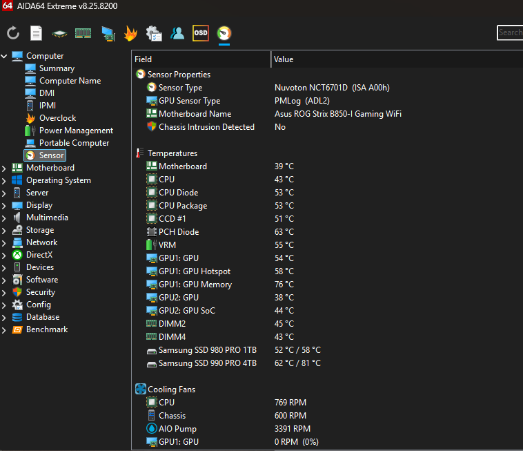

Fiery Posted February 25 Posted February 25 4 hours ago, Sherminator98 said: I just updated to the latest version (8.25.8200) and my sensorpanel is now MIA-I've checked/unchecked show SensorPanel several times and hit apply, hit the reset position button. rebooted and reinstalled Aida64, all without any luck and no screen what so ever comes up. If I select OSD-same thing, nothing shows. I guess the Sensopanels are fixed now-they don't work 😛 Does the Computer / Sensor page work properly? Quote
Sherminator98 Posted February 25 Author Posted February 25 I did some more digging into this just now and I had question-is the installer jacked up? I used Revo Uninstaller remove Aida64, i had two instances installed according to it, removed both. Downloaded the ZIP file, extracted it my downloads file and ran the aida64.exe. If I remember correctly, it said there was files in the C:/program files/finalwire/aida folder, so I said to over write them. Aida wouldn't launch after this, so I deleted the files. I ran the aida64.exe in the download folder-Aida started installing, but never created a new directory in C:/program files like it did before. I tried to move the folder manually to the program files directory, but couldn't since Aida64 was running and I couldn't even find it in task manager. Winded up going into safe mode, deleting aida64.exe from the folder and restarted. When I booted back up, Unzipped the Aida64 ZIP file into my downloads folder, then took the Aida64 folder it created, and manually moved it to program files. Ran the Aida64.exe file and everything seems to be working now and restored my sensorpanel settings. I need to reboot to see if it will work again after that. Quote
Sherminator98 Posted February 25 Author Posted February 25 Ok the sensorpanel was working, but after I logged off-Nada-doesn't come up. I tried rebooting also after this, and still no Sensorpanel even though its checked off to display. I'm even more confused now. Quote
