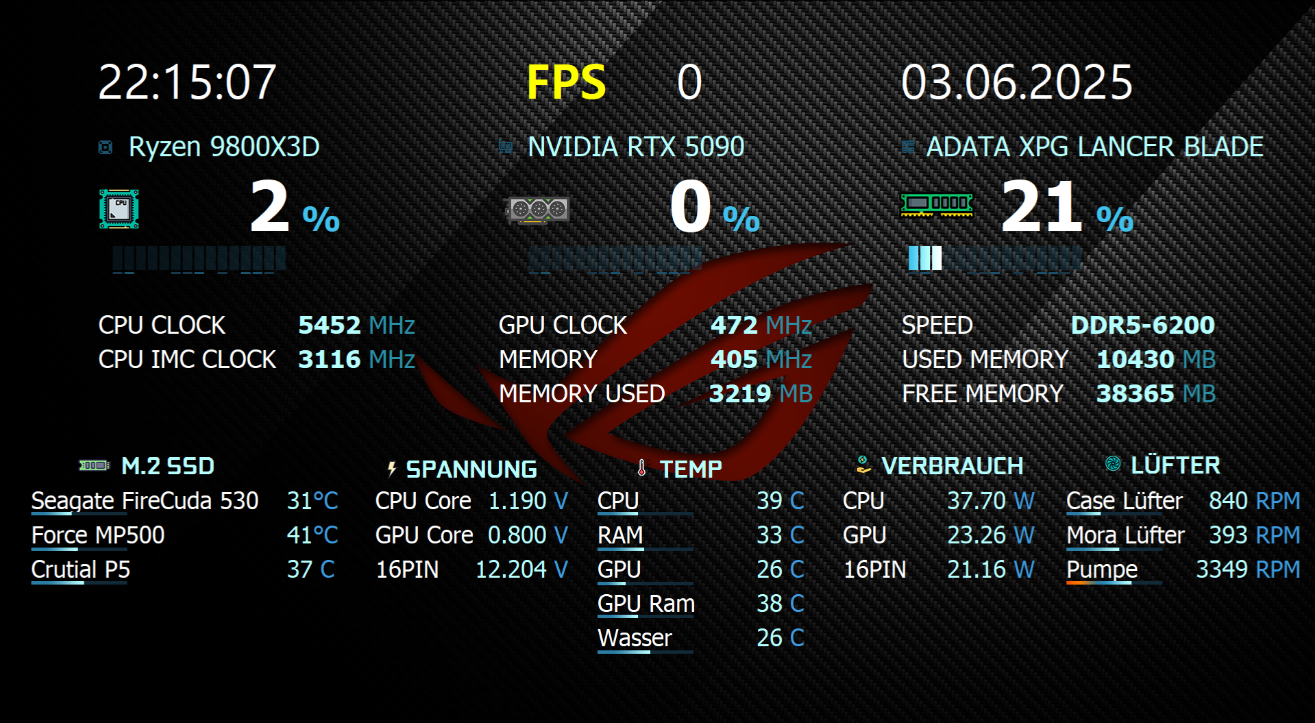

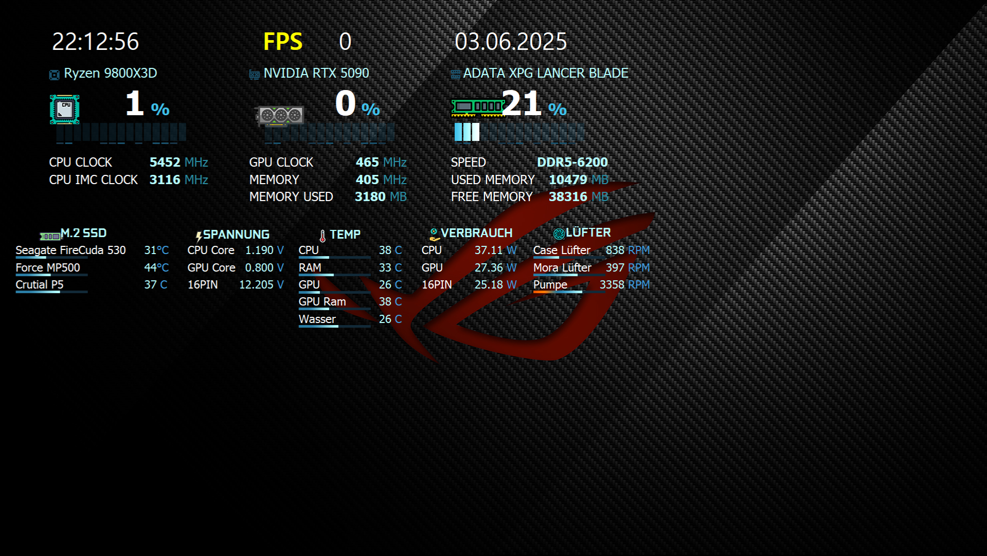

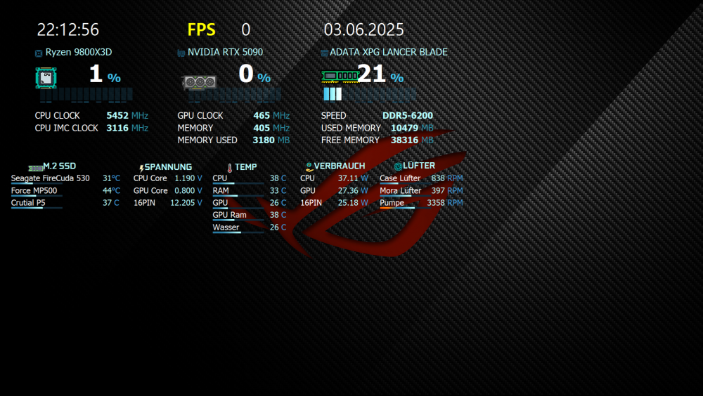

I Have also an Error with my Sensor Panel
I have a little Full HD 8" 60hz monitor for My sensor Panel and my Main Screen is a 4k 240Hz Monitor and i created my own SensorPanel Screen in 1920x1080 but with the Update 7.99 and your Update from today 7.99.7803 my Sensor Panel is now 1280x720P and i cant change it even when i change it manuel in the Settings to 1920x1080 the Font and all still the same 1280x720P
With the 7.99 and 7.99.7803Unbenannt2.thumb.png.e4f91d9df103d87087db6f3afd0e9a1a.png
With 7.65.7427
Posted
You may need to adjust your SensorPanel layout to conform the new AIDA64 version that supports per-monitor DPI awareness.  Is it only the width and height of the SensorPanel?  Or its layout fallen apart after upgrading to AIDA64 v7.99?
Posted
With the 7.99
With 7.65
Did you use any Windows compatibility settings with the old AIDA64, for example High DPI scaling override?

I've checked your layout, and sadly it was designed with the 150% scaling in mind, so AIDA64 scaled everything according to that setting.  When you import the panel back into a 100% scaled monitor (let's say you set 100% scaling for both your displays), the old AIDA64 version will show your panel incorrectly too.
I'm afraid after switching to the new AIDA64, you need to redesign your panel by multiplying everything (every X and Y coordinate and every item width and height) by 1.5 to get the correct layout back.  Make sure to do that process with the new AIDA64 version while your SensorPanel is already moved to the secondary (full HD) display.
We actually designed the new AIDA64 version to finally properly manage mixed DPI setups, but sadly there's a transition issue when the old SensorPanels may need redesigning in case they were designed with an over 100% scaling setting on the main monitor.
