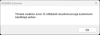

JariKoi Posted January 15 Posted January 15 2 hours ago, Fiery said: Does it crash during the time when you're not editing it too? So when e.g. you're viewing the SensorPanel? Yes, now it also crashes even if I don't modify it. I'll try to uninstall the entire program, reinstall it, and update it with the previous beta. Attached is the ISA Sensor Dump file. And this notification appears. Translated from Finnish --> Thread creation error: Not enough memory resources to process the command. First, the background image disappears from the panel, and then this error occurs even if you don't do anything. ISA Sensor Dump.txt update: I reinstalled and updated to the previous beta. Here is the ISA Sensor Dump file. Does the same thing too. isasensordump.txt I noticed that my Windows also updated today. Could that be the reason for this? These two updates were installed on the machine. https://support.microsoft.com/en-us/topic/january-14-2025-kb5050021-os-builds-22621-4751-and-22631-4751-0dabc772-4925-4d47-97c4-a792adb1e6d9 https://support.microsoft.com/en-us/topic/january-14-2025-kb5049624-cumulative-update-for-net-framework-3-5-and-4-8-1-for-windows-11-version-22h2-and-windows-11-version-23h2-dbb9e8e4-57fd-435a-bf5a-b9259b880ffa Quote
JariKoi Posted January 15 Posted January 15 I installed version AIDA64 7.35.7000 and now the panel has stayed on without crashing.🙌🕺 I already tried reinstalling AIDA64 7.50.7200 + the latest beta versions once before, but they just crash. I even removed the Windows update to see if it would help, but it didn't. Then I saved each image of my latest panel again in case one of the images is causing the crash. It would be great if there were an application that could scan image files and tell you if a particular image (.png) is causing the program to crash or if it doesn't work properly with it. So that you know to edit that particular image again. Well, for now, I'm using this slightly older version since it works without any issues, at least for the time being. Of course, I hope that a solution can be found for that, or that we could get some small add-on program to scan through the panel's files in case a file is causing the crash. Otherwise, it's quite laborious to go through the entire panel one image at a time. Kind regards - JariKoi 1 Quote

Fiery Posted January 20 Posted January 20 On 1/16/2025 at 3:25 PM, JariKoi said: I saved all the pictures again in case that was the reason? I don't know if it was because of that since the images are completely normal .png files that I use in each panel. Now I am using an older version of Aida because the two latest beta versions do not work. This 7.35.7000 version works normally. With that previous (aida64extreme_build_7210) beta version, I had no problems, and the issues started as soon as I updated to the latest beta. Even though I uninstalled the program and reinstalled it, the problems persisted. Thank you for your help in diagnosing this issue. The issue occurs when you use resizing on your image but the desired dimensions of the image matches the actual dimensions of your image, and so there's no actual need to resize it. So in your particular case you use a PNG file with 515x1920 pixels resolution, and you have a resize setting to 515x1920 configured. Once you disable resizing, the SensorPanel will start working for you again. In the next AIDA64 beta update we will implement a proper bug fix for this issue of course. 1 Quote
JariKoi Posted January 21 Posted January 21 22 hours ago, Fiery said: Thank you for your help in diagnosing this issue. The issue occurs when you use resizing on your image but the desired dimensions of the image matches the actual dimensions of your image, and so there's no actual need to resize it. So in your particular case you use a PNG file with 515x1920 pixels resolution, and you have a resize setting to 515x1920 configured. Once you disable resizing, the SensorPanel will start working for you again. In the next AIDA64 beta update we will implement a proper bug fix for this issue of course. Can you let me know when this is fixed and you have released a beta or stable version? Thank you. Quote
