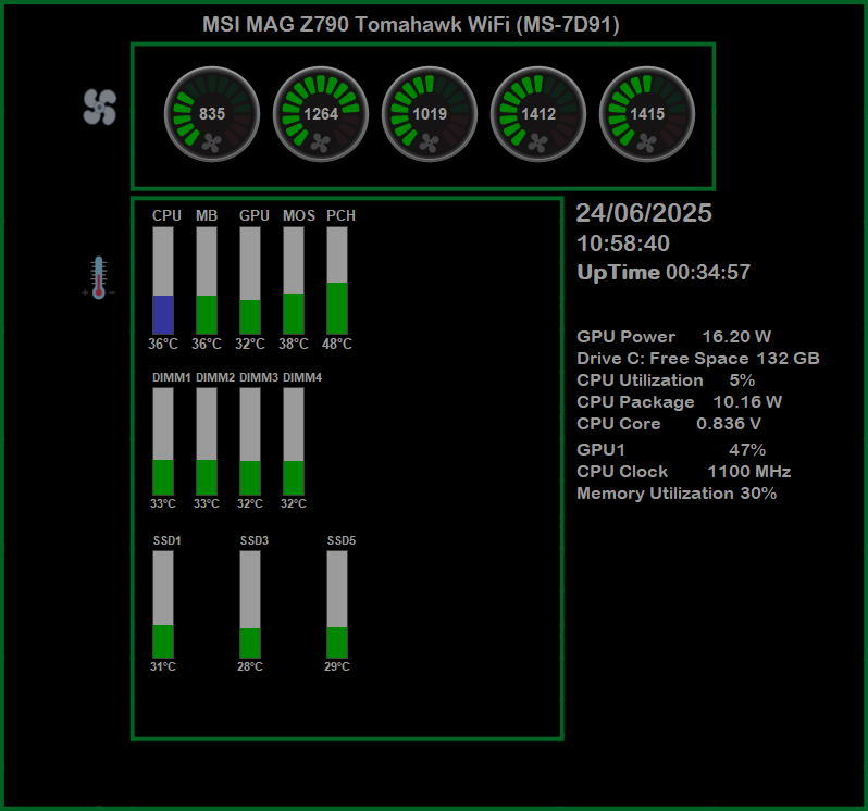

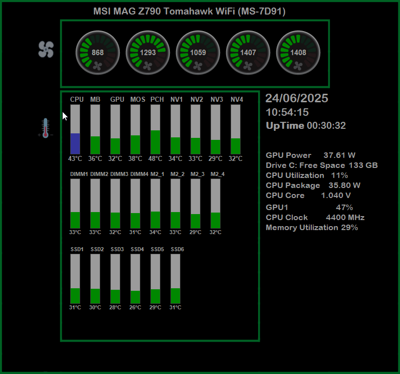

gjbth Posted June 24, 2025 Posted June 24, 2025 I have just tried the latest Beta version on a system with a MSI Mag Z790 Tomahawk Wifi (MS-7D91) motherboard. I have found that quite a few of the motherboard temperature sensors are not recognised when running this version. My sensor panel no longer displays many of temp readings. Quote
Fiery Posted June 24, 2025 Author Posted June 24, 2025 1 hour ago, gjbth said: I have just tried the latest Beta version on a system with a MSI Mag Z790 Tomahawk Wifi (MS-7D91) motherboard. I have found that quite a few of the motherboard temperature sensors are not recognised when running this version. My sensor panel no longer displays many of temp readings. Please let us know what exact temperature sensors are missing and what are they related to. When it's a SSD, please describe to what controller are they connected to (SATA, RAID or NVMe) and whether the drives are part of a RAID array. Quote

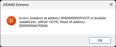

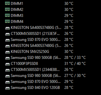

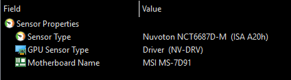

gjbth Posted June 24, 2025 Posted June 24, 2025 The Sensor type is reported by Aida64 as being Nuvoton NCT6687D-M (ISA A20H) This next screenshot shows the SSD/NVME temperature sensors that I have in the release version of AID64  This Screenshot shows the SSD/NVME temp sensors with the latest Beta version All of the NVME sensors are missing along with four of the SSD sensors. Two of the SSD's are connected to the onboard ASM1061 chip, the rest are connected through the Z790 chip, none are connected to a Raid. I am also getting the following error when running the Beta version Quote
Fiery Posted June 24, 2025 Author Posted June 24, 2025 10 minutes ago, gjbth said: The Sensor type is reported by Aida64 as being Nuvoton NCT6687D-M (ISA A20H) This next screenshot shows the SSD/NVME temperature sensors that I have in the release version of AID64  This Screenshot shows the SSD/NVME temp sensors with the latest Beta version All of the NVME sensors are missing along with four of the SSD sensors. Two of the SSD's are connected to the onboard ASM1061 chip, the rest are connected through the Z790 chip, none are connected to a Raid. I am also getting the following error when running the Beta version 1) In AIDA64 please press Ctrl+D --> Disk Debug --> ATA Dump. Copy-paste the full results into this topic, or attach the results as a TXT file to your post. 2) In AIDA64 please press Ctrl+D --> Disk Debug --> Disk Controllers Dump. Copy-paste the full results into this topic, or attach the results as a TXT file to your post. 3) In AIDA64 please press Ctrl+D --> Disk Debug --> RAID Dump. Copy-paste the full results into this topic, or attach the results as a TXT file to your post. 4) In AIDA64 please press Ctrl+D --> Disk Debug --> SMART Dump. Copy-paste the full results into this topic, or attach the results as a TXT file to your post. Thanks, Fiery Quote

Fiery Posted June 25, 2025 Author Posted June 25, 2025 15 hours ago, gjbth said: I am also getting the following error when running the Beta version Where in AIDA64 do you receive that error message? Quote
gjbth Posted June 25, 2025 Posted June 25, 2025 1 hour ago, Fiery said: Thank you! Please let us know to which SATA controller is your second KINGSTON SA400S37480G drive is connected to. I mean the one that is missing from the list of drives in the beta version of AIDA64. Both of the Kingston SA400 drives are connected to the same Asmedia ASM1061 controller Quote
gjbth Posted June 25, 2025 Posted June 25, 2025 1 hour ago, Fiery said: Where in AIDA64 do you receive that error message? I get this error if I left click on the Aida64 tray icon and select Open Aida64 Quote
Fiery Posted June 25, 2025 Author Posted June 25, 2025 7 hours ago, gjbth said: I get this error if I left click on the Aida64 tray icon and select Open Aida64 Thank you! Please check both this issue as well as the missing SSD temperatures issue in the latest AIDA64 beta build available at: https://www.aida64.com/downloads/latesta64xebeta Quote

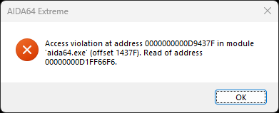

gjbth Posted June 25, 2025 Posted June 25, 2025 I powered the PC down about 30 minutes ago and have just restarted it. The access violation is back when starting Aida64. I had to click Ok six times to clear the six instances of the error dialog.     Quote
Fiery Posted June 25, 2025 Author Posted June 25, 2025 39 minutes ago, gjbth said: I powered the PC down about 30 minutes ago and have just restarted it. The access violation is back when starting Aida64. I had to click Ok six times to clear the six instances of the error dialog.  Do you have AIDA64 load at Windows startup? If yes, do you have its main window minimized or hidden? Quote
Fiery Posted June 25, 2025 Author Posted June 25, 2025 2 hours ago, gjbth said: I have just installed the latest beta from your link, Up until now i am longer getting the access violation error. But unfortunately the problem with the missing temperature sensors still exists. Thank you. We'll dig down deeper about the SSD issue. Quote
gjbth Posted June 25, 2025 Posted June 25, 2025 Just now, Fiery said: Do you have AIDA64 load at Windows startup? If yes, do you have its main window minimized or hidden? Yes I have Aida64 load at Startup and have the main window hidden Quote
