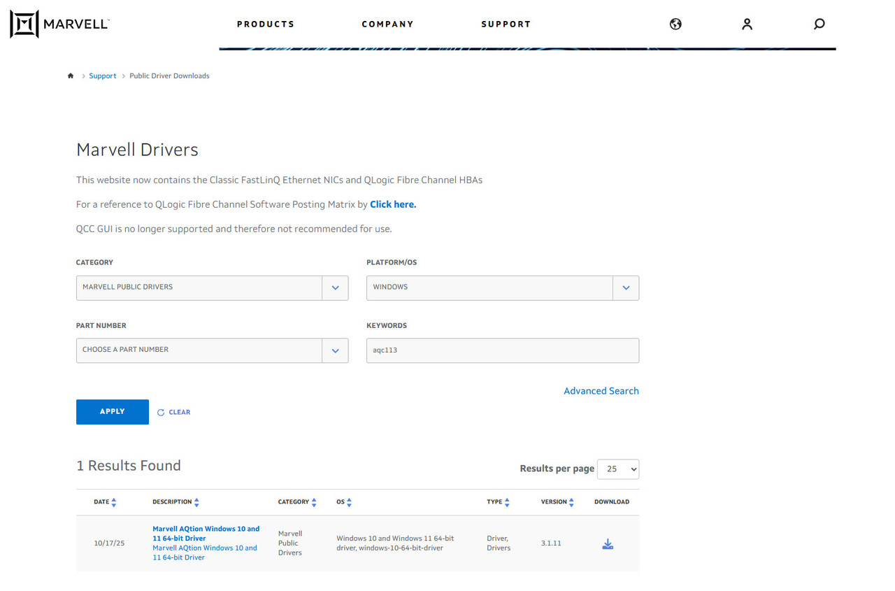

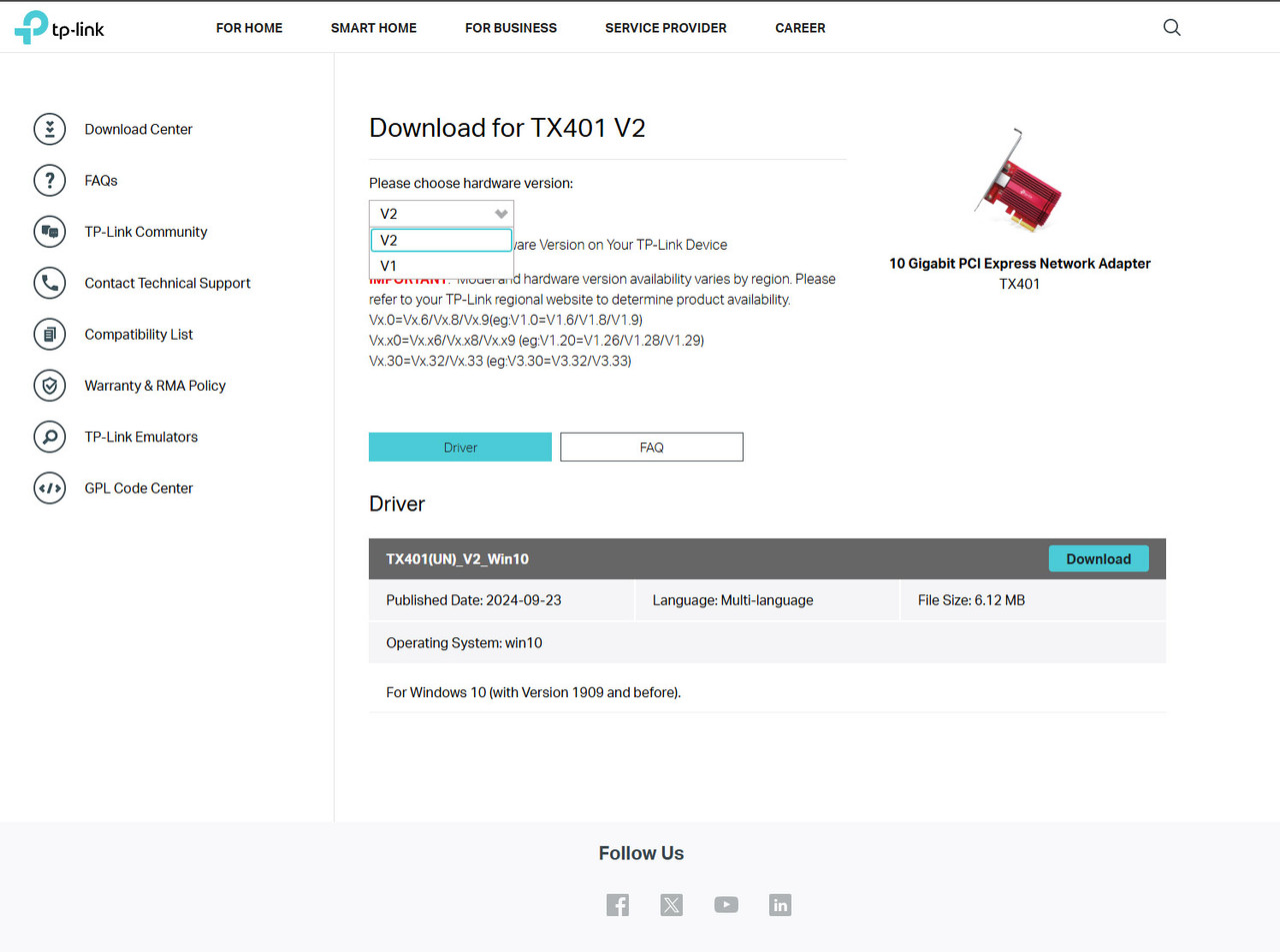

Yes, I believe I’m using the newer chipset. I purchased and installed the card today. Because of regional differences, our TP-Link support site lists only two hardware versions: V1 and V2. I initially forgot to check the version label on the card itself. However, the box label shows “UN/2.0” (Universal 2.0), which confirms it is a V2 card.
The TP-Link website provides drivers only for Windows 10, so I checked Marvell’s official site for alternatives. I haven’t installed those drivers yet, as my current connection is working without issues. I plan to wait until my new ISP broadband plan is fully set up before making any changes.

When I choose the v2 card TP-Link site shows more drivers - on my v1 I use the latest Marvell driver so far without any problems.
On one card I attached a temperature sensor and placed it on a spare AUX sensor spot on a Asrock EPC602D8A, Aida can read this sensor fine and reports it having 57C.
Yes, because regional requirements differ. That’s why your TP-Link support site still lists the V1 version. In our country, 10Gbps consumer adoption came much later than in other regions; we began introducing consumer-level 10Gbps broadband in mid‑2024, with rollout scheduled through 2026. So the V1 card was never introduced here. I just recontract my gamer plan from 2.5Gbps to 10Gbps.
