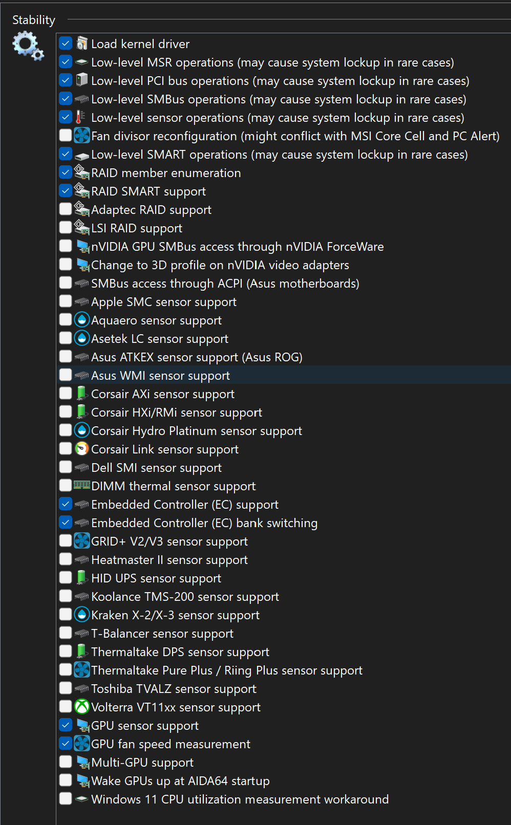

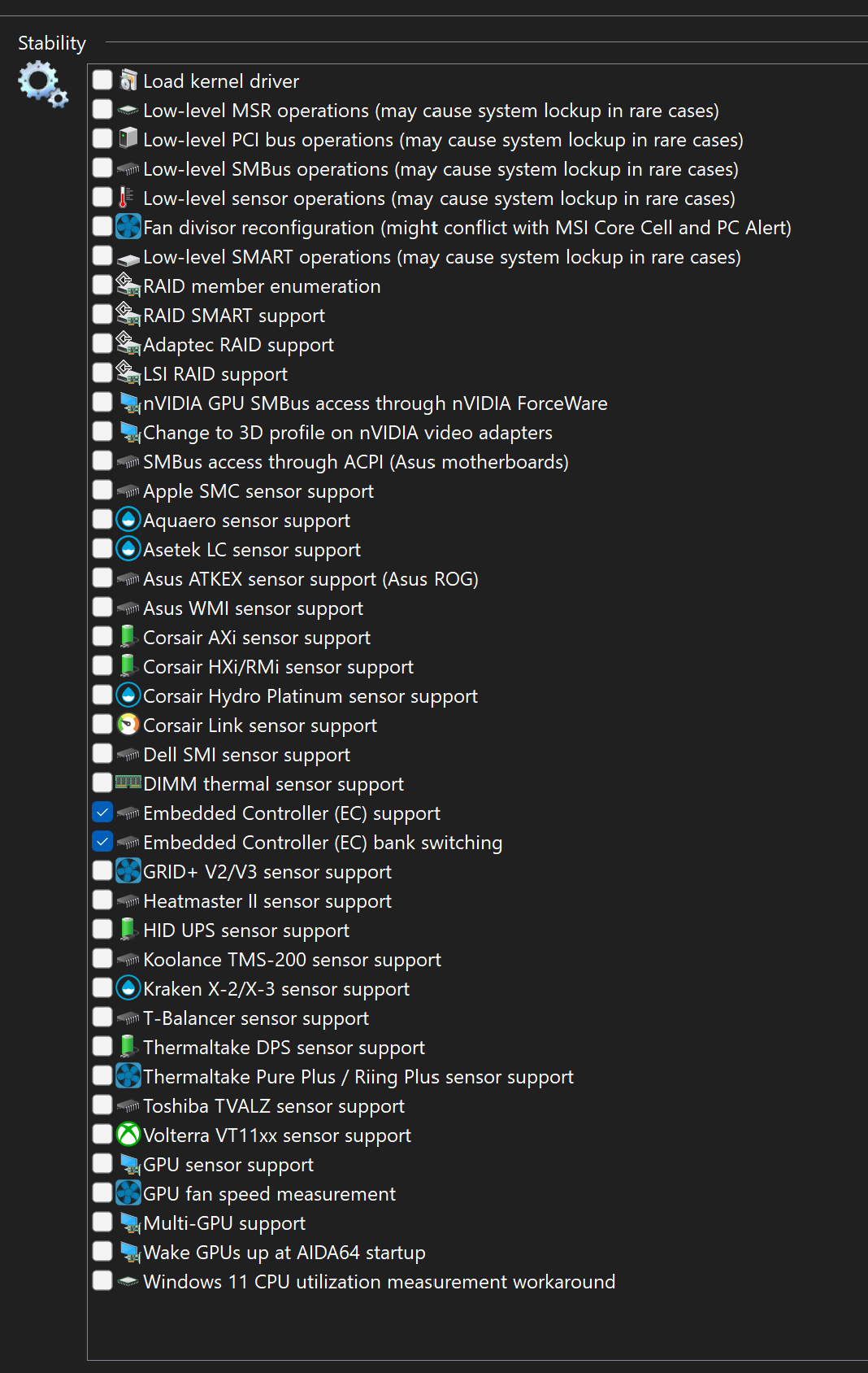

I found the minimum number of things checked for my sensor panel to work, wondering if that would improve latency ?  Unchecking all the things within my current session did not stop the subtle crackle pop noise that is still creeping in. I am on a fresh boot now using this arrangement. I also enabled MSI for my sound controllers.

Thanks for your reply.  I request you keep this thread open indefinitely as this interment problem is taking basically a whole week for one iteration at this point.
My current version is AIDA 64 Extreme v7.70.7503 and I am using the license that came with my Asus Products maybe it came with the Ryujin III or the z790 motherboard?  If I update, will my license still work? DO I need to backup my sensor panel files?
Current test results UPDATE:
I am still in my same boot session since Friday Sept 4th !!
It is now Sept 8th and the sound crackle symptoms have only just begun to become noticeable and the USBXHCI.SYS max latency has now climbed to 13ms.
Before unchecking all the boxes (I also increased poling period from 1s to 1.5s which may also be a factor), my problem would reliably deteriorate to more extreme levels with white noise explosions with in 1 day or so with max latency values 28+ms.
So, based on the current session the symptoms have improved a lot however it looks like things are still deteriorating with session length but at a slower rate. However this is a sample size of ONE and it is now taking 5 days to get one test result. so please keep this thread open .
For now I am going to continue the current session to confirm continued deterioration.
~Please advise

SUMMARY:
It passes with AIDA 64 at startup and LCD support disabled entirely.
It fails (audible crackling after about 21 hours) with AIDA 64 at startup and LCD support enabled even without any sensor items whatsoever.
Its something to do with AIDA 64 and Reujin III LCD display. I would think it would effect every one using a Ryujin 3 with the included AIDA 64 license to make a custom sensor panel. Is there anyway we can get this into to the Appropriate devs?
Below you can see screen shots showing the settings used in that most recent failed test.

DISABLE ALL OPTIONS UNDER STABILITY FOR NEXT TEST?
Maybe next test i will Boot AIDA 64 at start up with LCD support enabled with ALL sensor items removed (blank display) AND ALL options under stability unchecked .
had to reboot, white noise static explosions
9 pm 9-28-26 fresh boot LCD on, Zero sensor items, ALL check boxes in "stability" menu un checked.
Just realized the LCD support was unchecked for some reason, so i guess were beginning this test now 9-30-26 6:15 pm. LCD is now on, Zero sensor items, ALL check boxes in "stability" menu un checked.
10/2/26 3PM almost 48hrs no symptoms. gonna enable both  EC related options on the stability menu to see if that makes it fail over the next 40hrs or so.  note: Also just realized LCD update frequency has been 5,000 ms in this session.
10/3/26 6:30 am no symptoms yet, i just changed the 5,000 ms LCD update frequency to 100 ms.
10/5/26 9:45 am still in same session, no symptoms. LCD support is on, there is no sensor items on the display (display is blank with AIDA 64 splash screen). Both EC options are enabled under stability, been this way for about 50 hours :
10/5/26 9:45 AM: While still in same boot session, I an re enabling all my desired options under stability while LCD is still enabled with all sensor items removed (blank AIDA 64 splash screen on LCD display). This is to try and repeat and confirm the failure observed in earlier test trials.
