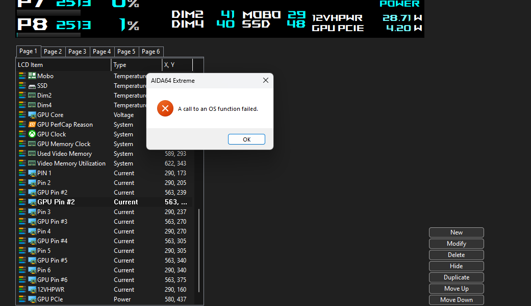

Per pin 12V-2X6 powerconnector monitoring ASUS Rog astral 5000 series
BlaKer replied to BlaKer's topic in Brainstorming
Got a beada panel that is connected with USB and only got one monitor connected. I will try to do that when i get the message again. -
Fiery replied to BlaKer's topic in Brainstorming
Are you configuring the SensorPanel with the configuration window placed on the same monitor as the SensorPanel, or you have multiple monitors and you dedicate one of them for the SensorPanel? Can you please also create a broader screenshot where we can see from what window (of AIDA64) does that popup comes up from? -
Thank you so much =D!! The Beta build got this bug , im messing around in the sensorpanel and get this message from time to time when trying to add somthing or just browsing the sensors to add. Im using W11. Not all the time. -
Please find the fixed AIDA64 beta build at: https://www.aida64.com/downloads/latesta64xebeta -
