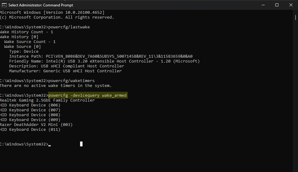

On 7/10/2025 at 10:04 PM, BHSY said:
Thank you for the testing. I had placed an order for PH to 9-pin USB cable and let's see if the device will prevent my system from waking up from sleep mode. In the meantime, I'll exit/close AIDA64 program to shut down the device. I'll let you know once I recive the new PH cable and tested it. Thank you.
I finally received the PH cable, but it was the wrong size.😅
Anyway, I finally found out what was causing my computer to wake up from sleep mode when using the TURZX display.
I came across this article and used the command prompt: powercfg -devicequery wake_armed, which listed the following devices that wake up my computer, as shown in the screenshot below. The weird thing is that none of these devices wakes up my computer before I enable the tulcd, unbelievable 🤔. After disabling the 'Allow this device to wake the computer' from the listed devices, my computer continues to stay in sleep mode even with the tulcd enabled.😊
Now, I am unable to wake up my computer using my wireless keyboard and mouse; instead, I use the power button to wake up my computer.😅
Posted
Thank you for letting us know about the resolution :)
