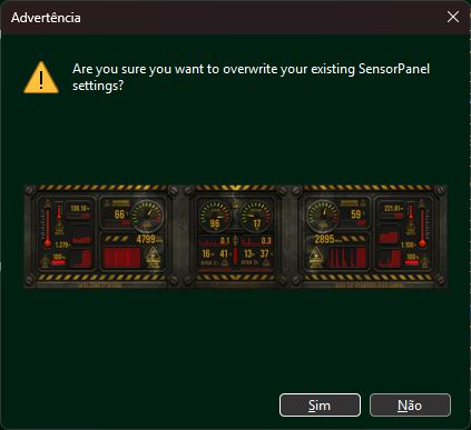

Fiery Posted May 30 Posted May 30 Hi Guys, We're thinking of showing a preview image when you try to import an SPZIP format SensorPanel layout. So below the question "Are you sure you want to overwrite your existing SensorPanel settings?" in the same dialog it would show you the layout thumbnail. If you like the idea, let us know if the filenames preview.jpg and preview.png for the preview image would be suitable for you. So in case AIDA64 finds an image placed in your SPZIP archive named preview.jpg or preview.png it will not use it for the layout but just as a preview image shown at import. Quote

Sensor Moderators COSTAJUNIOR Posted May 30 Sensor Moderators Posted May 30 5 hours ago, Fiery said: Hi Guys, We're thinking of showing a preview image when you try to import an SPZIP format SensorPanel layout. So below the question "Are you sure you want to overwrite your existing SensorPanel settings?" in the same dialog it would show you the layout thumbnail. If you like the idea, let us know if the filenames preview.jpg and preview.png for the preview image would be suitable for you. So in case AIDA64 finds an image placed in your SPZIP archive named preview.jpg or preview.png it will not use it for the layout but just as a preview image shown at import. I fully support the idea of showing a preview image when importing an SPZIP layout into SensorPanel — this would definitely make the process more intuitive and help avoid mistakes when selecting a layout. The filenames preview.jpg and preview.png are appropriate, and I personally prefer PNG for its transparency support and better definition. I’m also not opposed to the file extension — whether it's JPG or PNG, either one works fine for me as long as the preview image is displayed correctly. Looking forward to seeing this improvement implemented. Quote

Fiery Posted June 2 Author Posted June 2 On 5/30/2025 at 11:37 PM, Surjeet said: Thank you. Got the answer. Waiting for this feature to be implemented at the earliest !! @BHSY @COSTAJUNIOR Here it is: https://www.aida64.com/downloads/latesta64xebeta Please note that we've already implemented this new feature in the next-generation AIDA64 development build. Learn more at: 2 Quote

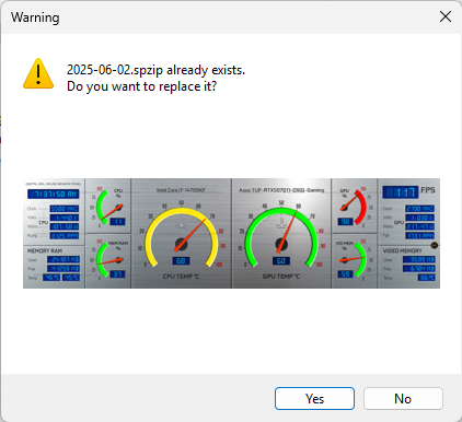

BHSY Posted June 2 Posted June 2 On 5/31/2025 at 4:17 AM, Fiery said: You need to make sure a file named preview.png or preview.jpg gets into the SPZIP package. It can be a hidden image on your layout with the required filename, or after creating the SPZIP file using the Export feature on the SensorPanel Manager you can open the created SPZIP file (with a tool that can alter ZIP archives) and place the file manually there. I got it after reading the above post. I set my preview.jpg as a hidden image in SensorPanel Manager. Thank you🙏. Is it possible to show a thumbnail preview when I want to export the file? What I mean is, after creating or saving a new SPZIP file with the preview.jpg or preview.png placed in the SensorPanel Manager, show a thumbnail preview under the "*.spzip already exist. Do you want to replace it?" when we want to overwrite the same file again, to make sure we overwrite the correct file. Below image is an example: Quote
Fiery Posted June 2 Author Posted June 2 57 minutes ago, BHSY said: Is it possible to show a thumbnail preview when I want to export the file? What I mean is, after creating or saving a new SPZIP file with the preview.jpg or preview.png placed in the SensorPanel Manager, show a thumbnail preview under the "*.spzip already exist. Do you want to replace it?" when we want to overwrite the same file again, to make sure we overwrite the correct file. Below image is an example: Yes, it's coming too, soon. Showing that at export is a bit more complicated than at import, so it will take a bit of time to make it happen in a proper way. 2 Quote
BHSY Posted June 2 Posted June 2 11 hours ago, Fiery said: Yes, it's coming too, soon. Showing that at export is a bit more complicated than at import, so it will take a bit of time to make it happen in a proper way. Oh WOW! That is so great.☺️ Look forward to your next beta update. I forgot to mention that now I can finally stress test my ASUS TUF GAMING RTX 5070 TI GPU Card using the System Stability Test. Thank you🙏. Quote
Fiery Posted June 2 Author Posted June 2 14 minutes ago, BHSY said: Oh WOW! That is so great.☺️ Look forward to your next beta update. I forgot to mention that now I can finally stress test my ASUS TUF GAMING GPU Card using the System Stability Test. Thank you🙏. Thank you, and I'm glad we're making progress Please post your experience on the next-generation AIDA64 in its own topic, to make sure others can see what it delivers too: Quote
Sensor Moderators COSTAJUNIOR Posted June 2 Sensor Moderators Posted June 2 I would like to congratulate the entire team. I have tested the new image preview feature during sensor import, and I can confirm that it is working flawlessly." Quote

Fiery Posted June 3 Author Posted June 3 23 hours ago, BHSY said: I got it after reading the above post. I set my preview.jpg as a hidden image in SensorPanel Manager. Thank you🙏. Is it possible to show a thumbnail preview when I want to export the file? What I mean is, after creating or saving a new SPZIP file with the preview.jpg or preview.png placed in the SensorPanel Manager, show a thumbnail preview under the "*.spzip already exist. Do you want to replace it?" when we want to overwrite the same file again, to make sure we overwrite the correct file. Below image is an example: Showing the preview at export has been implemented in the latest AIDA64 beta update available at: https://www.aida64.com/downloads/latesta64xebeta Quote

BHSY Posted June 3 Posted June 3 55 minutes ago, Fiery said: Showing the preview at export has been implemented in the latest AIDA64 beta update available at: https://www.aida64.com/downloads/latesta64xebeta Oh WOW!😮 I did not expect the export preview thumbnail to be released so soon. I've tested it and it shows my thumbnail. Well done💪, Fiery, and thank you so much!🙏 Quote
Fiery Posted June 3 Author Posted June 3 Just now, BHSY said: Oh WOW!😮 I did not expect the export preview thumbnail to be released so soon. I've tested it and it shows my thumbnail. Well done💪, Fiery, and thank you so much!🙏 Thank you for your feedback 1 Quote
