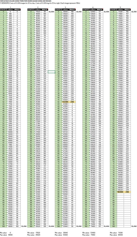

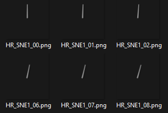

BHSY Posted June 30 Posted June 30 (edited) I finally completed a functional clock and date sensor gauge. For the hour gauge, I used the 'Time' gauge type (86399), which will show the hour hand moving. The process of creating hours hand using 5 sensors, 240 images for AM and 240 images for PM is too complex and difficult for me to explain. I used Excel spreadsheets to calculate the min/max values. Click the screenshot below and click the zoom icon to view the Excel spreadsheet image. To me, I'll use the 'Hour (1-12)' and 'Hour (0-23)' for digital time, for example, 12:00, 17:00, 13:00, etc. For the minute's hand, I used 61 images (_00.png to _60.png), from 12.00 to 12.00, and the min/max value is 0 and 60. For the seconds, I used 61 images (_00.png to _60.png), from 12.00 to 12.00, and the min/max value is 0 and 60. 20250630_174221.mp4 @Fiery The minutes and seconds sync very well with my OS time. However, for the second, some of them will skip a second, even using 'Simple Sensor Item'. For example, from 24s it jumps to 26s, skipping 25s. Please watch the above video. Is there any way to improve the seconds without skipping? It's ok if there's nothing that can be done about it. I'm quite satisfied with how the new time and date gauges work. AIDA64 is the best customization sensor panel. Thank you to you and your team for making this possible. Well done!🥰💖 Edited June 30 by BHSY 3 Quote
Fiery Posted June 30 Posted June 30 1 hour ago, BHSY said: I finally completed a functional clock and date sensor gauge. For the hour gauge, I used the 'Time' gauge type (86399), which will show the hour hand moving. The process of creating hours hand using 5 sensors, 240 images for AM and 240 images for PM is too complex and difficult for me to explain. I used Excel spreadsheets to calculate the min/max values. Click the screenshot below and click the zoom icon to view the Excel spreadsheet image. To me, I'll use the 'Hour (1-12)' and 'Hour (0-23)' for digital time, for example, 12:00, 17:00, 13:00, etc. For the minute's hand, I used 61 images (_00.png to _60.png), from 12.00 to 12.00, and the min/max value is 0 and 60. For the seconds, I used 61 images (_00.png to _60.png), from 12.00 to 12.00, and the min/max value is 0 and 60. 20250630_174221.mp4 263.7 kB · 0 downloads @Fiery The minutes and seconds sync very well with my OS time. However, for the second, some of them will skip a second, even using 'Simple Sensor Item'. For example, from 24s it jumps to 26s, skipping 25s. Please watch the above video. Is there any way to improve the seconds without skipping? It's ok if there's nothing that can be done about it. I'm quite satisfied with how the new time and date gauges work. AIDA64 is the best customization sensor panel. Thank you to you and your team for making this possible. Well done!🥰💖 Wow what a layout 🤘 😍 As for second skipping, try to lower the SensorPanel update rate to 500 milliseconds or even 200 ms. If it doesn't help, then it means either the collection/measurement of sensor items takes too long, or rendering your exquisitely complex SensorPanel layout takes too long. 2 1 Quote
