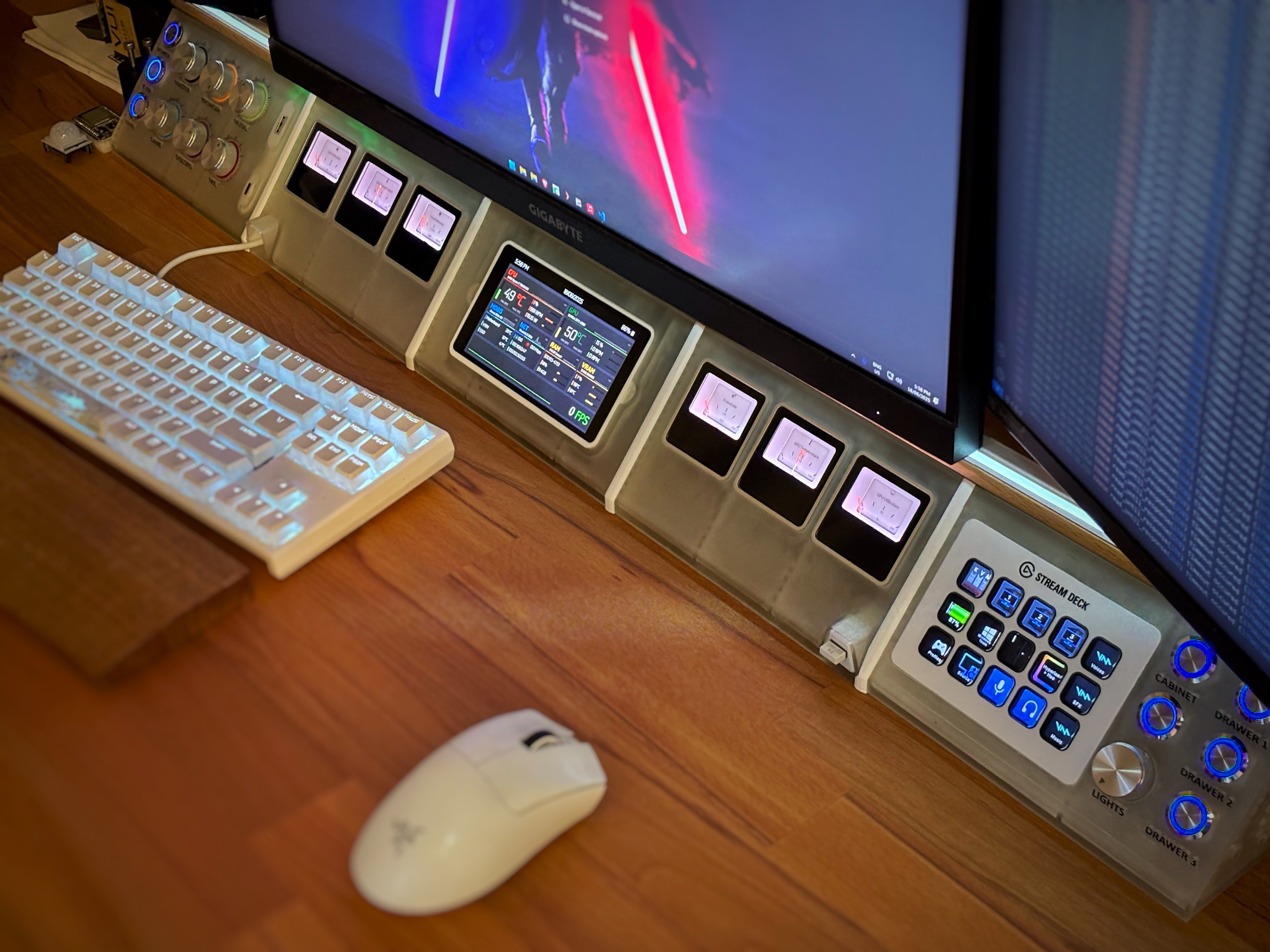

I tested all 6 gauges also, if it helps, I have attached an image, I love the aesthetic, and it works so flawlessly. Only suggestion I would have would be to pull the gauge name from the API (And maybe sort by name in the dropdown), as it was a little hard to tell what gauge is what when setting up 6, but honestly nothing too extreme, and once they are setup once, they have the "CPU" etc name tag which makes updating easy :)

Thank you for your feedback!  Your dashboard looks spectacular!

Thanks! I really appreciate it, started out fairly simple but I just got a new resin printer and wanted to throw myself into the deep end and ended up here haha, chose clear because I have LEDs behind the monitor and the panel that replicate what is on the screen, The gauges, along with the physical pots etc, love it!
