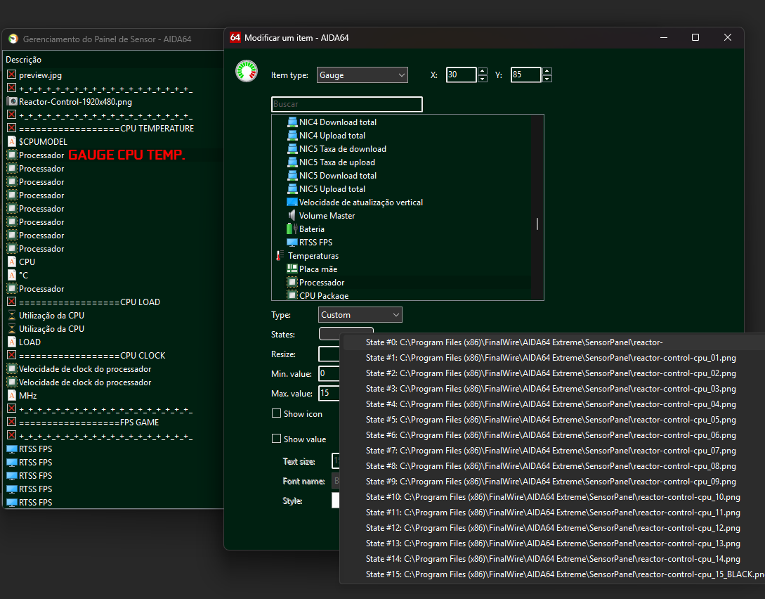

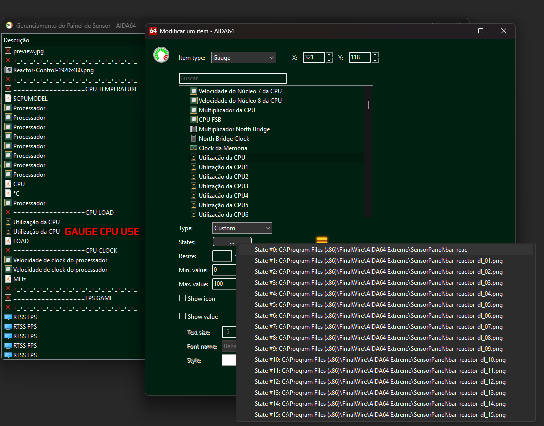

Sensor Moderators COSTAJUNIOR Posted June 4 Sensor Moderators Posted June 4 After this latest update, I noticed a bug when creating a custom gauge: the first entry doesn’t show the full name, as you can see in the image. It should appear like this: bar-reactor-down_0 (gauge with 16 states). The same thing happens when I create a gauge with 8 entries and 100 states — always on state #0. For example, the name should be reactor-control-cpu_00, but it’s getting shortened, as shown in the image. This issue only happens with state #0; all other states remain correct. Another thing I noticed: when creating a new gauge, the icon is no longer the old circle shape. Now it appears with the same icon as the sensor — in my case, the processor icon. Was this change intentional? Will it stay this way? I really preferred the old icon because it made it much easier to visually identify the gauges. Quote
Fiery Posted June 4 Posted June 4 1 hour ago, COSTAJUNIOR said: After this latest update, I noticed a bug when creating a custom gauge: the first entry doesn’t show the full name, as you can see in the image. It should appear like this: bar-reactor-down_0 (gauge with 16 states). The same thing happens when I create a gauge with 8 entries and 100 states — always on state #0. For example, the name should be reactor-control-cpu_00, but it’s getting shortened, as shown in the image. This issue only happens with state #0; all other states remain correct. Another thing I noticed: when creating a new gauge, the icon is no longer the old circle shape. Now it appears with the same icon as the sensor — in my case, the processor icon. Was this change intentional? Will it stay this way? I really preferred the old icon because it made it much easier to visually identify the gauges. Do you select the 16 states (in your first example) in a single round by selecting 16 files in the file open dialog? We've tried that but couldn't reproduce the bug As for the state icon, that is due to a limitation of the new compiler. We had to remove it to avoid visual issues to occur. We'll try to find a way to put it back or find another way to indicate the SensorPanel item type (e.g. gauge) as well as the sensor type (e.g. temperature) in the same chart cell. Quote
Sensor Moderators COSTAJUNIOR Posted June 4 Author Sensor Moderators Posted June 4 7 minutes ago, Fiery said: Do you select the 16 states (in your first example) in a single round by selecting 16 files in the file open dialog? We've tried that but couldn't reproduce the bug Yes, I’ve already tried everything. I even tested it with older sensors that used to work fine, and the issue is still happening. So it doesn’t seem to be related only to the current method, which makes me wonder if this problem is only happening to me. 😔 Quote
Fiery Posted June 4 Posted June 4 Just now, COSTAJUNIOR said: Yes, I’ve already tried everything. I even tested it with older sensors that used to work fine, and the issue is still happening. So it doesn’t seem to be related only to the current method, which makes me wonder if this problem is only happening to me. 😔 Even if you only alter the first state by selecting a single file, the filename still gets cut? Quote
Fiery Posted June 4 Posted June 4 20 minutes ago, COSTAJUNIOR said: Yes, I’ve already tried everything. I even tested it with older sensors that used to work fine, and the issue is still happening. So it doesn’t seem to be related only to the current method, which makes me wonder if this problem is only happening to me. 😔 We could finally reproduce the bug. It seems to be only a visual issue. In other words, even though the filename looks cut, the actual filename is properly used by the custom gauge. We will still fix the issue of course 1 Quote

Fiery Posted June 4 Posted June 4 2 hours ago, COSTAJUNIOR said: Perfect, thanks for the update! Glad to hear you were able to identify the bug. Even if it’s just visual, it’s good to know the internal functionality is working correctly. Looking forward to the fix — thanks for the continued effort! 😊 Funnily enough, this one seems to be a compiler bug that we cannot fix on our end. Apparently there's a 78 character limitation on the caption of the very first item in popup menus. What we can do is add a header to the popup menu as a workaround. We will also report the compiler bug to Embarcadero. Quote
