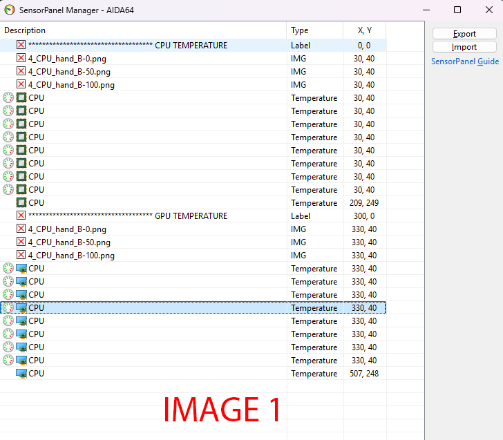

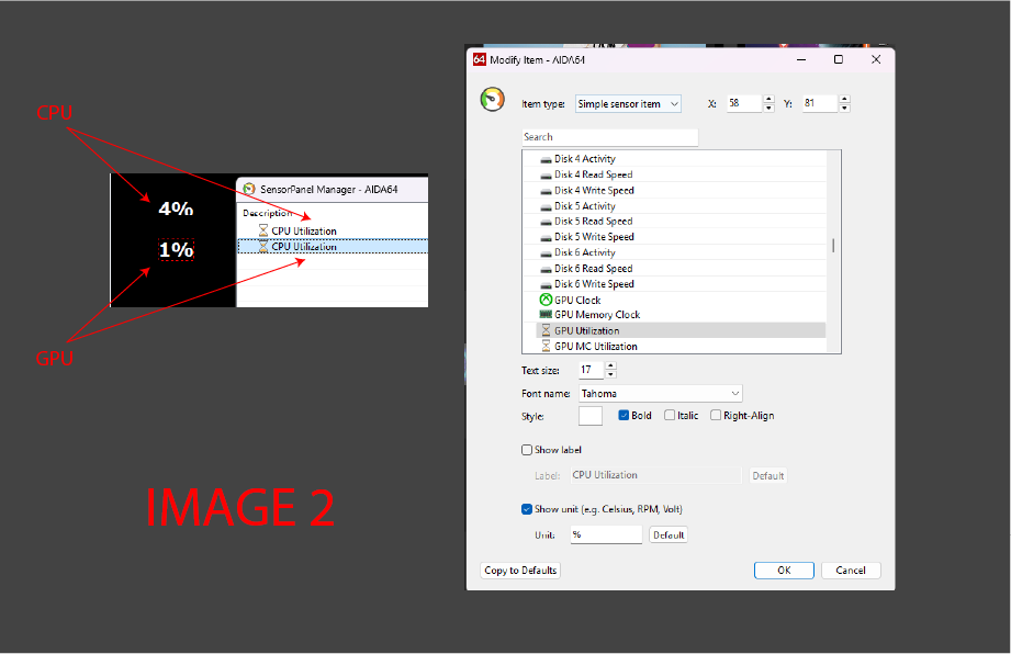

Thank you so much for implementing the 'Change Souce'.🩷
Everythings works as we hope, especially the min/max values were retained as it was. However, the sensor description did not change.
Please refer to the IMAGE 1 below, I have duplicated all the CPU sensors and change them to GPU sensors. However, the description still shows as CPU. It should changed accordingly to the 'Item type' in the Modify Item.
Add: Is it possbile to select all the same 8 custom sensor gauges and change them all at once, instead of one at a time?
As for the IMAGE 2, the item type is a 'Simple sensor item'. I duplicated the CPU Utilization and change it to GPU Utilization but the description still showed as CPU Utilization. The only way for me to change the description is to enable the 'Show label' and type in GPU Utilization. Also, I think it is better for the 'Show Label' to changed too when we change to a different sensor, regardless if the 'Show Label' was enable or disable?
Thank you!
Everythings works as we hope, expecially the min/max values were retained as it was. However, the sensor description did not change.
Thank you!
1) We'll implement changing source for multiple selected items in the next AIDA64 beta update.
2) As for the label update issue, we wanted to tread lightly and avoid updating it automatically because we got from the discussion above that it's not something you'd prefer to have.  However, there may be multiple use cases: maybe the label shouldn't be updated only when it's shown on the layout?  So when you don't have the label enabled (for Sensor Items and Simple Sensor Items) and when the label is not a visual part of the item (for Gauges and Graphs) we can freely update it automatically, can't we?

Posted (edited)
Thank you.
I see, I get what you mean and you are right. No need to make any changes to the Simple sensor itemlabel.
Edited by BHSY
Posted (edited)
6 hours ago, Fiery said:
Label is the default name for a sensor item.  E.g. "CPU Package" is the label for ... well... CPU Package temperature :) When you change the source, the label is not updated right now.  When you have the label overridden and shown on your layout, updating the label automatically may be something you'd prefer not to happen.  When the label is now shown on the layout, then I suppose updating it would be best since then in the list of items (in the SensorPanel Manager) you'd better understand and follow the source changes you may apply.
Correct me if I'm wrong but I think the label you mention to Surjeet refers to the 'Simple sensor item', am I right?
What about the gauge/custom gauge? Can the gauge/custom gauge description be changed automatically on the SensorPanel Manager?  For example, after I duplicate the CPU temperature gauge and change it to GPU temperature gauge using the 'Change Source', only the icon has changed but the description still shows as CPU Utilization (Please take a look at the attached image). The only way to change it is to go back to the Modify window but that defeats the purpose of using the 'Change Source'.
Edited by BHSY
Added a screenshot
