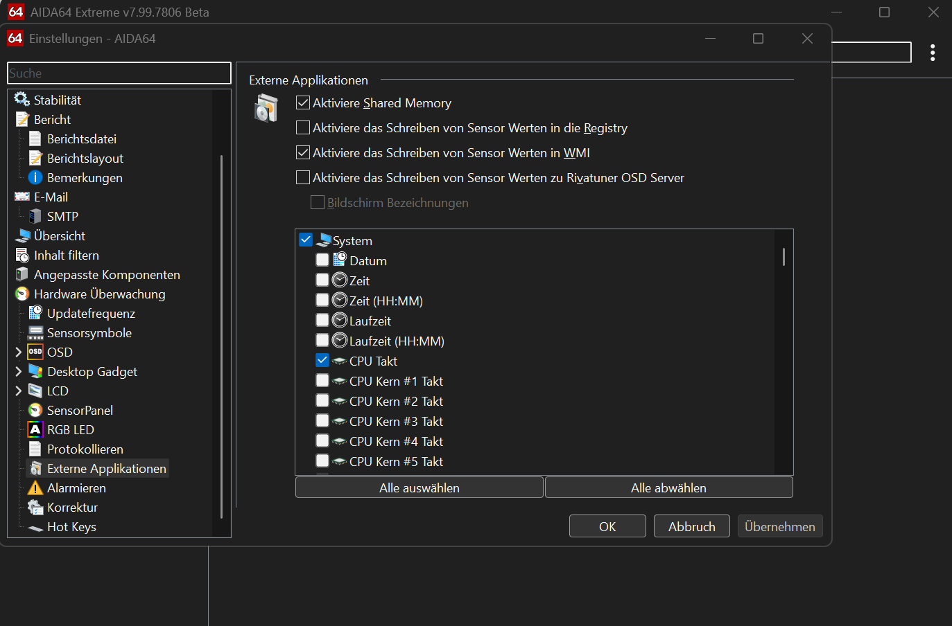

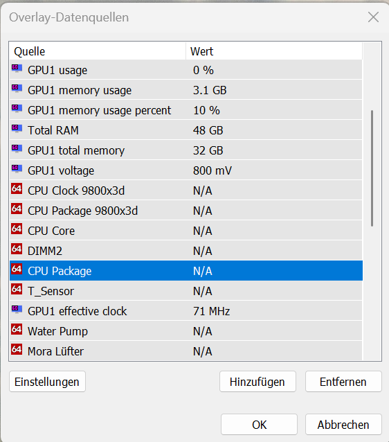

Benni231990 Posted 22 hours ago Posted 22 hours ago I Update your latest 7.99 Beta but still got no Sensor Data in Rivatuner Quote
Fiery Posted 2 hours ago Posted 2 hours ago 20 hours ago, Benni231990 said: I Update your latest 7.99 Beta but still got no Sensor Data in Rivatuner We've fixed the issue in the latest AIDA64 beta update available at: https://www.aida64.com/downloads/latesta64xebeta Quote
