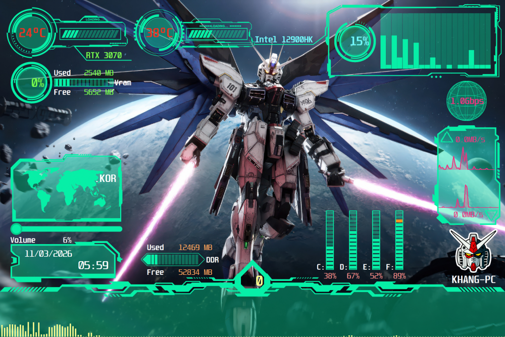

Gnusmas Posted April 5, 2024 Posted April 5, 2024 Hey guys, im searching for the template from the attached image, screen resolution 1024x600. Do any of you who is older here on the forums know where i can find it and download it? Thanks you so much for the help! 1 Quote

Gnusmas Posted April 5, 2024 Posted April 5, 2024 On 1/14/2024 at 11:41 PM, ValhallasAshes said: I hope you don't mind. I really liked your sensor panel, but needed it in a 1024x600 format to work with my G.Skill WigiDash. I used the 1920x1080 version as my baseline and I had to manually edit and touch up each of the elements to make it work with the smaller screen. I did make a few alterations to better suit my needs though. Such as I didn't really need to have the min/max icons and info for the CPU and GPU. So in the CPU section, I replaced those with individual skinny bars for each of the logical threads on my CPU. So on the top right, I kept the area graph for the overall CPU usage, but under the CPU temp, I have usage bars for all of the CPU cores/threads. And in the GPU section, I traded the min/max temp identifiers for a GPU Hotspot reading. I had a recent issue with my GPU where the package reading kept saying the GPU was operating at safe temps, but my GPU would constantly over rev at full pelt. It wasn't until I checked the Hotspot temp that I found the GPU had a Hotspot temperature delta of well over 40 degrees hotter than the package temp. For reference, the Hotspot should be less than half that delta. A massive difference that it never should've been, pushing the GPU to well over 100 degrees under full load. That information, had I known it earlier, would've prompted me to replace the thermal paste years ago, but due to my only knowing about the standard temp reading, I relied on that reading to assume that the card was operating normally even though my gut told me something was wrong. Even MSI when I called them about it, told me it was probably just a defective sensor. Turned out the opposite was true. The card knew exactly what was wrong. Afterburner just never showed that sensor's reading to me. Replacing the thermal paste fixed that issue and the card now runs the way you would expect it to. Thankfully due to my paranoia during the issue, as a precaution, I ran the GPU for years undervolted to keep the fans from over revving. That must've been just enough to keep the card from cooking itself to death until I could find the cause of the problem. As a result of that experience, I now consider the hotspot temp to be a critical piece of information. So I replaced your min/max values with that reading instead. I saw someone else asking for the 1024x600 version of your minimalist sensor panel, but for the life me, I can't find it again. So I thought I would post it here in case anyone else wanted it. I hope you don't mind. As mentioned, I originally needed this for my G.Skill WigiDash sensor panel. Before anyone asks, no I don't have two GPUs. My GPU simply has two separate fan controllers. Hence the two GPU fan readings. I'm going to upload two different files. One is the standard 1024x600 version of the sensor panel and you will be able to know which one it is by it having the .sensorpanel extension at the end of it's file name. The other file I'm going to upload is a version specifically for the G.Skill WigiDash and you will be able to know which one it is by it having the extension .gslcd at the end of it's file name. While yes, technically both files can be imported and will work for either the standard sensor panel function or Wigidash (LCD section of Aida64), the reason I've done two versions is due to a technical discrepancy between what G.Skill marketed the screen's resolution to be and what Aida64 detects the screen's resolution to be. G.Skill originally advertised the WigiDash to have a resolution of 1024x600, but in practice, Aida64 recognizes the screen as having a resolution of only 1016x592. A discrepancy that does affect the alignment of the sensor panel on the WigiDash screen. So the .gslcd WigiDash version of the file includes offsets to compensate for the resolution mismatch to fix the panel's alignment. So make sure to download the version that's appropriate to your use case. Standard version (Final revision): Blue_Minimalist_1024x600_Rework.sensorpanel 181.46 kB · 330 downloads WigiDash version (Final revision): Blue_Minimalist_1024x600_Rework.gslcd 181.55 kB · 291 downloads GeForce Font: geforce_light.otf 118.92 kB · 216 downloads Thanks again to VeilSide for creating this incredible sensor panel. It's exactly the style I was wanting and with a few tweaks, it has all the information I wanted. Simple, clean, informative, looks great while being organized and easy to read. And completely unbranded. I love it. Great job Veilside, and I hope you don't mind me sharing a modified version of it. EDIT: Found a couple text misalignments. Fixed them and updated the files in this post. Also posted the GeForce Font file. Forgot to include that in the original post. EDIT 1/16/24: Adding this as a recommendation. The GPU package and hotspot temp reading felt way out of proportion to the elements around them. They were just way too big. So I've rescaled and realigned them a little to make them look better within the overall panel. Because I know most people edit all of the hardware titles and certain other elements to conform to their personal rig's specifications, I thought it would be easier for everyone who wants it to simply edit the 4 elements themselves rather than downloading new files and having to re-edit all of their hardware stats. So for those who've already downloaded the above files, here's some screenshots highlighting the 4 elements changed and those who want to can update their panels themselves relatively quickly: Standard Version: WigiDash Version: Simply change those four elements text size to 36 instead of 42 and adjust the x,y coordinates to match those shown in the image. Oh, and I also indented the Package and Hot Spot titles in a little bit. Their new x,y coordinates are also visible in the images. Then export to your chosen file to permanently save it. For those of you who'd rather just download the updated files without having to update them yourselves, I've already updated the main files so new downloaders get the latest version. Sorry if this update caused any confusion. It was just bugging me, and my OCD made me fix it. This will probably be the last update I do for this panel unless I think of a major change I want to make. But if that happens, I'll just make a new post next time instead of updating this one again. Maybe a different color like red, green, or purple. I kinda think a yellow/orange/gold version of this panel might look really good. I'll consider it if I have time. So guys, i browsed like crazy the thread and i have found out that @VeilSide created first this template and he named it Blue Minimalist, then @ValhallasAshes reworked and change it to his need and to 1024x600 resolution, i downloaded Valhalas reworked template and its cool and i thanks both Veliside and ValhalasAshes for their work and for the template but if anyone knows exactly the one in my picture which is clear that is made after Valhalas and they changed Fans to Fans & Pump and instead of System under the Fans is something that looks like a bar, they added the date too.... if you know exactly the template please let me know. Also what System means under the Fans, is it the chassis fans ? I need to learn to add a pump instead of GPU #2 under fans, and please if someone know what that bar is in the picture that is swapped for the System let me know. I never had to deal with templates so i need to learn but i ordered a 7" screen for my PC. 1 Quote
