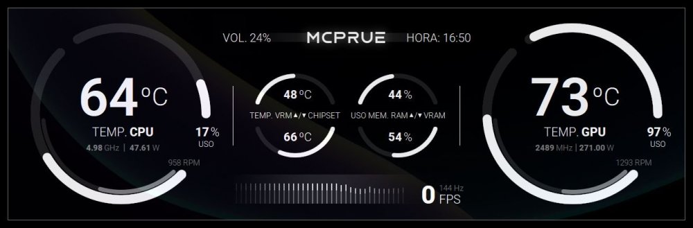

FreeZer Posted August 5, 2018 Posted August 5, 2018 Hello Here is my panel of ROG control for my second screen 1920x1080. I realized with photoshop at 80% There are some changes to make. Image 1 is without photoshop Image 2 with photoshop Sorry for my english I am french. 11 Quote
